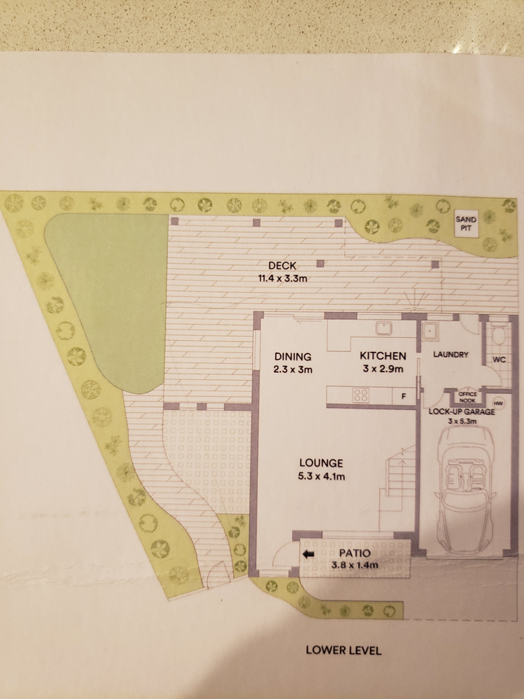

Do you have a floorplan of the whole duplex that you could share? It would help members to see what you were working with.

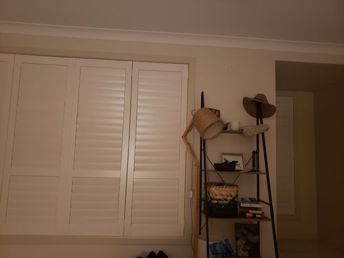

We actually had plantation shutters on both the door and window but removed them as they really ate into the space 😑 and for example at the door could never be fully open to the outside. We do love them though and have them at the front of the space. See pic.
Here's a diagram of our floor space. Internal space small but a lovely deck to open to...somehow 😃

The first thing you'll need to check is what changes you are allowed to do by contacting your strata manger, as this is a duplex. Strata may or may not impact your design decisions. If it is under strata management, you may not be permitted to alter the external appearance at all.
If you are allowed to make the changes, I like what @MitchellMc suggested (bi-folds or triple stacker doors). If you choose bi-folds, you could have a matching one in your kitchen too. If stackers, then you might look at a gas strutted awning window for the kitchen.
If you hate bugs, then you'll have to factor in the cost of retractable fly screens with byfolds or strut hinged windows. You can have stacker fly screens with stacker doors.
I think that unless you can widen the gaps, I am not sure whether the changes you would like to make will be worth the money it will cost to do them (my opinion only). I hope I've helped in some way.
