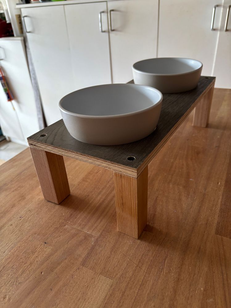

Here is a simple little project to make life easier for your cat, I read that a cats feeding bowl is better if it was elevated a little bit making it easier for the cat to digest the food, I made this stand using left over pieces of floor board and timber for the legs.
Overall size, 430 mm long x 200 mm wide x 120mm high.

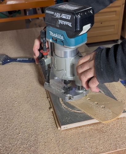

Makita 18 volt trim router
Home made circle cutting jig.

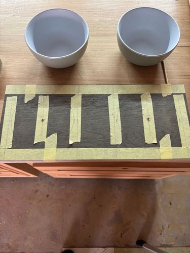

Double sided tape to hold timber in place whilst routering out the circles.
Philips head screw driver.
Drill and drill bits to suit.
Sandpaper 240 grit.
Cut timber plank to size
Mark out circle size to suit bowls

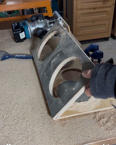

Cut holes for bowls using router and circle jig.
Sand all edges.

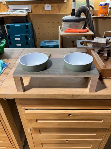

Measure and cut 4 legs.
Drill and screw legs to timber top.
Apply two coats of varnish
Add rubber pads for bottom of legs.
