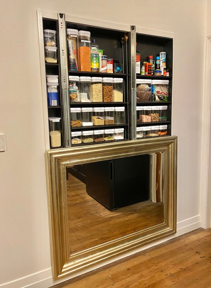

I’ve designed a hidden pantry using the cavity space in the wall and a framed mirror as a frontage, so you’d never know there is hidden storage for pantry items!. I’ve used a counter weight that I’ve attached under the house to make for an easy, smooth operation.

Firstly I cut a whole out the same size as the mirror centred in between the door and the wall.
Step 2
Boxed it out with timber that I to size
Step 3
positioned the runners for the mirror onto the studs of the house for stability
Step 4
added a counter weight under the house via the gate track wheel
Step 5
Cut tiles to create shelves specifically for the containers in the photos
Step 6
Added the tiles
Step 7
painted a gloss trimmed

Thanks Mitchell!  I’m really happy with the result and to be part of this community.  The counterweight is pretty perfect so can be easily lowered/raised with a finger fyi.😊

Would love to see how you worked the counterweight out? When I saw the cover pic I thought mmm that mirror might get broken (had a fishtank sitting on theh floor once and acidently kicked something small and saw it travel all the way across and go "ting" not a good outcome) then looked closer and saw the verticle rails and thought "What the?" :smile: Love the idea and such a good way to keep space and keep things tidy!

Thanks Dave!  Appreciate the feedback.  I do lots of renovating but unfortunately am pretty useless taking photos along the way.  I don’t start with much of a plan - whatever I’m working on just unravels.  The closest thing to install photos is the before shot that I’ve attached.👍🏽

:smile: Yeah that has happened to me too many times and I take a LOT of photos. Sometimes it just gets forgotten until the work is done. Thanks for the photo and still that shows what a vast improvemnet you have done! :smile: Will keep your idea in mind. Now if only I needed a safe..... :smile:
