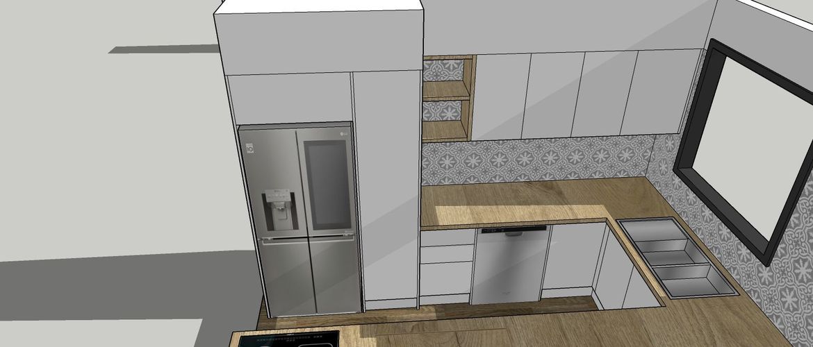

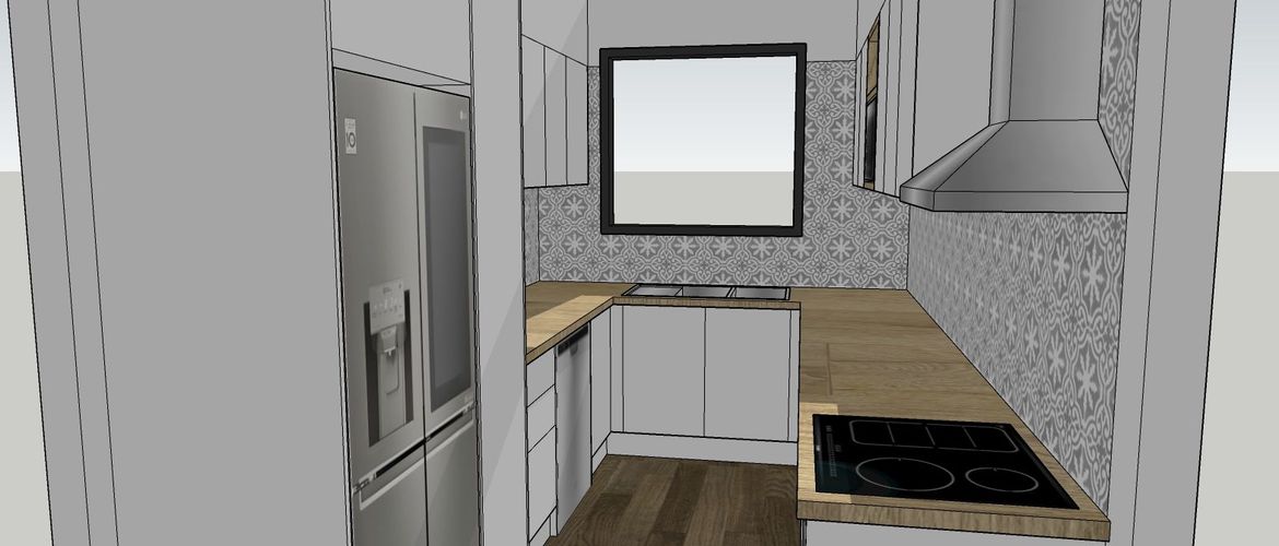

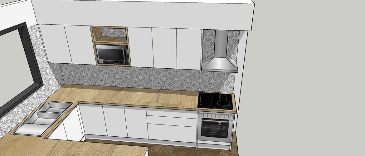

Since your ceiling is so high I can understand why you would want to have your cabinets go all the way up. Please note that doing so will have a heat transfer effect inside your cabinet. When you open them you will notice that they will be warm and will not be an ideal condition for food items inside your wall cabinets. Unless your ceiling is insulated then this phenomenon will occur! I only mention it as my pantry is currently in the same state. I would rather suggest that you have a bulkhead built to cover the gap between the wall cabinet and the ceiling giving you that "all the way to ceiling look" your after. Plus it is a cheaper alternative to having custom cabinets. I left most of the appliances in the same place with exception of the pantry that I moved to the other side near the fridge. I don't know if you want a dishwasher but there is a provision for it and can be taken out and a cabinet put in it's place should you decide otherwise. Cook top and oven are in the same spot to save on having to pay the sparky to move the electrical points. The sink stays in the same spot near the window and I have moved your microwave into a cabinet giving maximum bench top prep space! Enjoy the drawings and please post should you have any questions. Good luck and stay safe!
