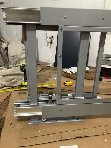

Thanks for the responses… most helpful and now I have another conundrum I am putting in the blind corner pullout basket and I think I need to change something around as the ‘front wheels’ are at the back
Hi @TT
Have you installed the base plate for the slideout mechanism? Just remember that the orientation of the standup pullout mechanism is towards you. The set has pre-installed wheels at the back and the wheels at the front need to be installed manually. If you watch the installation video you'll see that the foot of the standup pullout is installed very close to the wall of the cabinet opposite its hinge.
Here is a handy step-by-step guide:

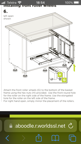

Thanks buuut I have wheels at the back and no other wheels supplied or from looking at it no where to put them… it appears to work fine and I will re-visit when doing all the finishing touches
Hi @TT
I've attached some photos to illustrate where the extra two wheels go. If they are missing from your packet, please ask the store to provide you with those two missing wheels. If you've installed them in another location, please remove them as they need to be at the front of the assembly to carry the weight of the baskets.
