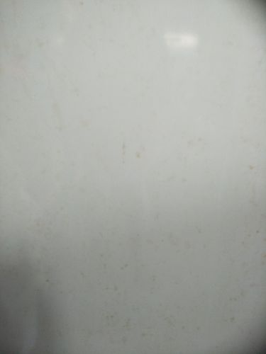

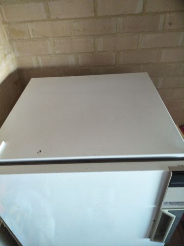

It's an old faithful Westinghouse Freezer(Australian made) we've had for 35+ years just as a spare in the garage. There's a bit of rust around the handle and very light spots on the front door, one side of the fridge and same on top, nothing major. I'll try and post some pics from my phone later.

Thank you very much for posting those photos of your fridge. It seems you are at the very early stages of rust development. I suggest washing the top and front of the fridge with a washcloth along with soap and water. Then wipe it with Selleys Sugar Soap Wall Cleaning Wipes - 25 Pack. Your goal is to remove all the wax, oils and debris that's attached to the fridge.
Once you've fully dried off the fridge, I suggest using Bondall 250ml Ranex Rustbuster Rust Converter. Make sure to give the rust converter enough time to work before wiping it off. Generally, I would recommend sanding the surface of the fridge but it looks like you are still able to do a touch-up of the surface.
I suggest using White Knight 300g Gloss Appliance White Paint And Prime. This is an all-in-one product and can be sprayed directly onto the surface of the fridge. Please note that the white finish will be different from your current refrigerator colour. I suggest masking those areas you don't want the spray paint to go on to.

Thank you very much for posting those photo updates of your fridge. Your spray painting looks good and the fridge looks brand new again. Wrinkling is often caused by unequal drying during the painting process. From the surface, it looks like the paint is, but underneath that dry surface, the paint is still wet. When a new coat is applied the semi-dry paint moves as it continues to dry causing wrinkling to occur.
My only tip is to give the paint a few extra days to dry off, one of the best ways to tell is to gently touch the surface of the paint and if it feels like it's sinking the paint underneath is still wet. Don't be tempted to use a hairdryer or a heat gun as these tools will only dry off the surface and not cure the paint underneath.
