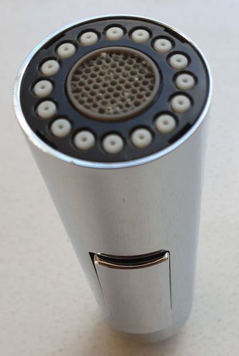

I need to remove the cartridge from my moderna tap.

Are you by chance referring to a Mondella kitchen pullout tapware? The picture you've posted is called the Vege Spray Head. Can you please tell us a little bit more about what's been happening with your tap? Has it been leaking or has the head been malfunctioning?
If it has been leaking the the ceramic cartridge is located near the tap handle and not the spray head. But if the spray head has not been working properly you can replace it with a generic head such as the Kinetic Bell Style Vege Sprayhead.

Thank you Eric, I'll check those links tomorrow. The tap is as you described...the pull out model. It is only about 3 weeks since I had it installed, but yesterday I had a heat bank hot water system installed, and the initial flush through had some "fibres" or something in it that are caught in the wire mesh in the tap. I am wanting to remove it so I can clean it. The tap itself us performing well.

If that's the case, I suggest bringing the Vege Sprayer out to the garden and use your garden hose to do a reverse flow procedure to clean it. Generally, all you need to do is to set your garden hose to a streaming or jet function if it has one and point it towards the outlet of the Vege Sprayer. This will force any debris caught in the aerator to flow back out to the other side.
The other way to do it is to use the special circular wrench that came with your tapware. If by chance you still have the accessory kit that came with your tap you should find a circular plastic wrench that has special teeth on it that will allow you to remove the aerator. If it is no longer in your possession, you'll need to do the reverse flow cleaning.
Thanks again Eric however it seems my luck is out. When I purchased this about 4 weeks ago, we picked it from one that was on display, however, under the display models, there was only one left, and that box had been opened. I checked that all the components were there, and as far as I could tell they were. Not knowing there was an accessory kit with a special spanner that was supposed to be there it looked complete to me...which, as it turned out it was...except there was no accessory kit. I noticed when I was in the shop yesterday that a number of the display taps had pieces missing, so I guess it is a common occurrence that people help themselves to what they want...a sad indictment of today's world. I have already tried the reverse flush...unsuccessfully. Are you able to tell me if the aerator unscrews or does it just clip in? I don't suppose there's a chance one of these spanners could be ordered?

Yes, unfortunately, it is fairly common for this kind of thing to happen. It's incredibly frustrating I must say.
My suggestion is to head back to your local store with your receipt and speak to the team on the Special Orders desk. They will either take one from another box if they are available or will be able to order a replacement part for you.
