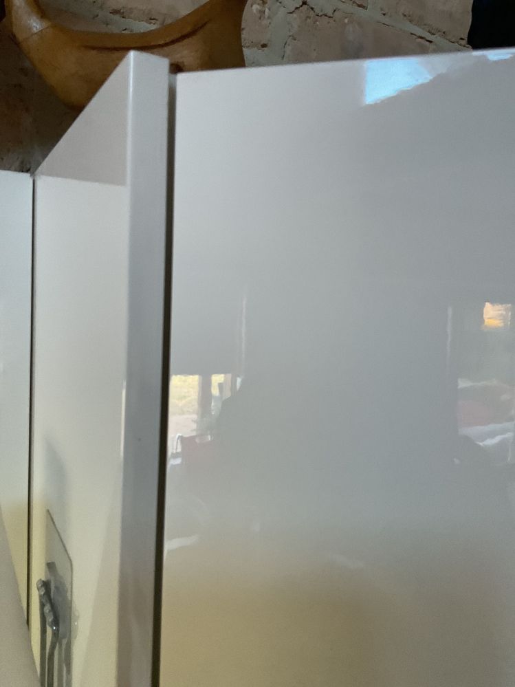

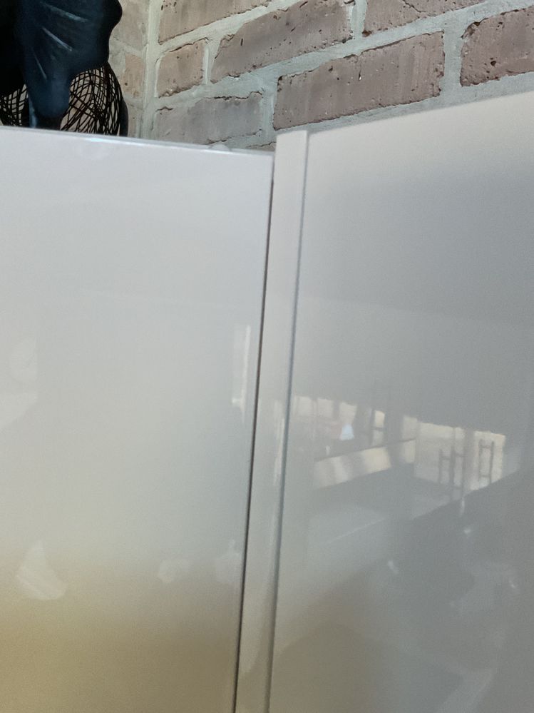

Door touches pantry side when closing
The photo with the narrow opening is the handle side. The photo with the wider gap is the hinge side. Hinge side gap is wider at the top than at the bottom. Handle side is narrow at the top and wider at the bottom

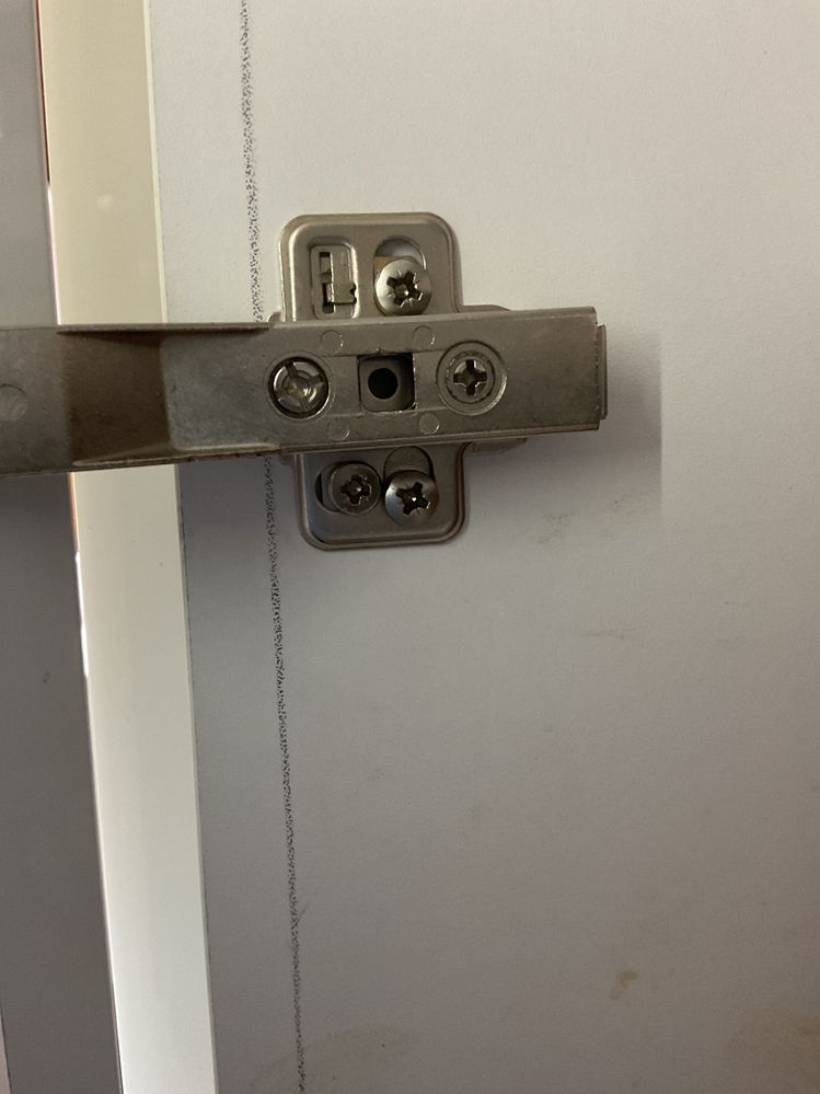

So then I have one more question. From the photo, which screws loosen off the middle hinges?

Looking at your photo, I believe the top needs to be adjusted so the door moves towards the side wall of the cabinet and the bottom may need to move away from the side wall of the cabinet slightly.
Looking at the issue, you should only need to rotate this screw on the hinges.
This will push the hinge out from the sidewall of the cabinet, which will adjust the gap between the door and the side wall of the cabinet when it is closed.
Rotate the screw I have circled above on your top hinge. You should see the hinge pull closer to the side wall. If it is pushing away, then rotate the screw in the opposite direction. Rotate it half a turn and assess before making further adjustments.
The three middle hinges look like they are in the correct place, so you may not need to touch them.
The bottom hinge may need some slight adjustment in the opposite direction to the top hinge. Follow the same process of making small adjustments and checking.
You should be able to do all of this without the need to remove anything, it may just take some trial and error.
