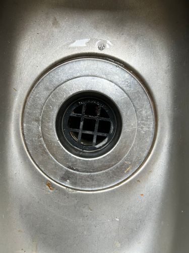

Hi Jacob!
We have a sink waste like the one you mentioned in the picture, however it has a screw in the middle.
Our previous strainer looks almost identical, however it doesn’t have the long metal stick down the base. I have purchased the same one as the OP, but it won’t go in our sink because of the screw. Can I remove the screw or is it important?
Hi @karlyfraser,
A warm welcome to the Bunnings Workshop community, it's fantastic to have you with us.
I would have to see it to give you an answer with any confidence.
Can I trouble you to upload an image of your sink waste?
Let me know if you need a hand with this, I'm happy to help if required.
