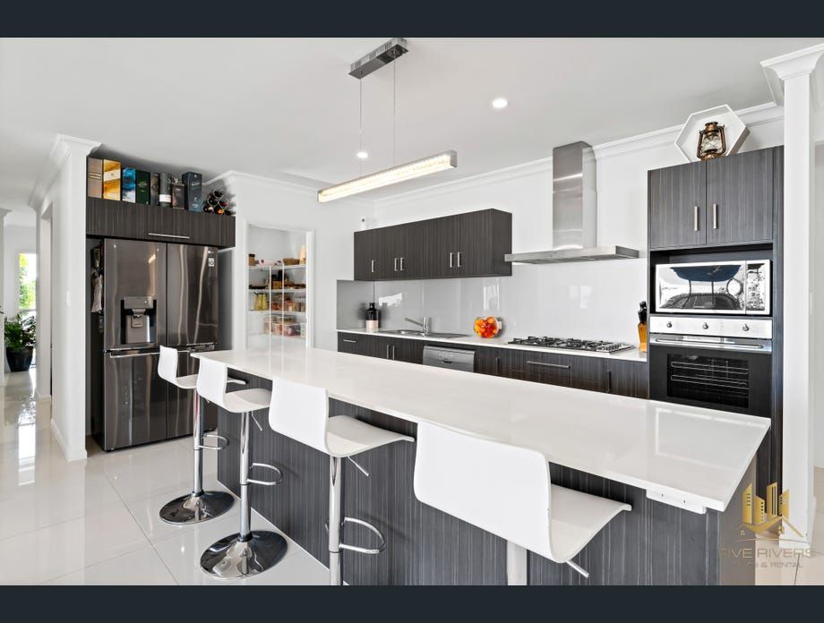

Hi, just wondering how much / how easy or hard it would be to replace a kitchen splashback. The place we're moving into has one which originally thrilled me, until I saw the colour [no colour, just a bland grey]. So I'm hoping to make it green, but not sure if I would have to replace it altogether or if it could be removed, recoloured & put back. Excuse my ignorance as I brace myself for replies I don't want to hear
I live in Cairns now by the way but can't seem to find someone who can give advice on this stuff. Thanks a lot.

I probably wasn't clear, I still want to retain the glass splashback as I've always wanted one of those, I just want to change the colour, is the colour usually behind on the wall or part of the glass itself? Excuse my ignorance! Thanks again.

Thanks for responding, I guess I wouldn't mind painting the glass if you can do that, [I don't want tiles, prefer the glass look that's already there but just want a different colour]. If you can paint glass, do you know if it's easy to clean/maintain? Thanks again.

I do apologize for misunderstanding your request. Transparent splashbacks such as acrylic and glass are often painted from behind to protect them from getting chipped, scratched and damaged. If the splashback is painted from the front, I'm afraid the paint will get damaged in a very short time. Unfortunately, the paint will not be able to withstand detailed thorough cleaning, hot oil, hot water and cleaning chemicals you might be using to clean your benchtop.
Putting another splashback on top of the old one is possible but presents its own set of limitations. The grey colour might rise through the new splashback, as in a very light shade of grey will be present visually. Glue lines may be visible as you are putting together two non-porous substances. These are some of the things that could happen if the old splashback is not removed.
I'm afraid there's no effective way to paint the splashback without the paint peeling off. If you're really keen on that green splashback, I recommend removing the old splashback so that there will be no surprises when it comes time to install the new splashback.

Thanks Eric, so it sounds like I have to remove the current glass & replace it altogether if I want to change the grey splashback to green. I'll brave some quotes on this I guess as it sounds like the colour is actually behind the glass, on the wall? Either way it sounds like it'll be a project! Thanks again
