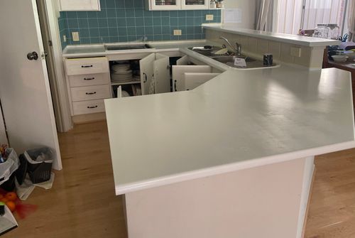

I did 4 coats of “Dulux renovation range tiles and bench top paint” . At least 8 hours of wait between each coat.
It looks fantastic, but I am still not sure whether my kitchen can be back to full use. Heard that needs at least 7 days. Afraid chips or cracks when placing plates , cups etc on bench top .

Thanks Eric.
the weather is not completely warm yet. Will wait for at least 7 days then.
The kitchen is much brighter with white benchtop. Hopefully it will turn out to be good strong finish.
Re: how long to wait until full kitchen uses after applying Dulux renovation range benchtop paints?
That looks amazing @ritcho! Great work.
