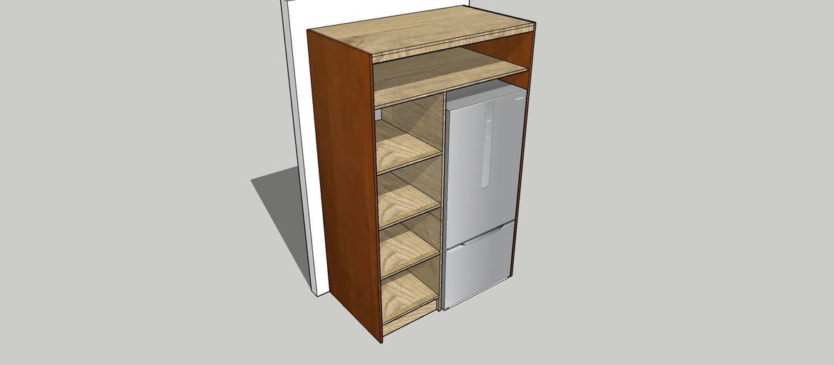

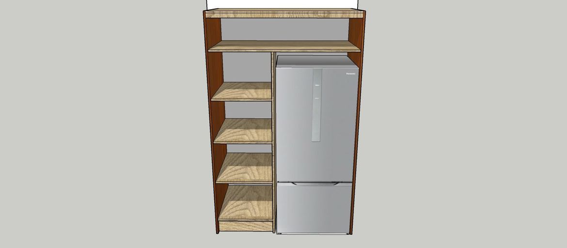

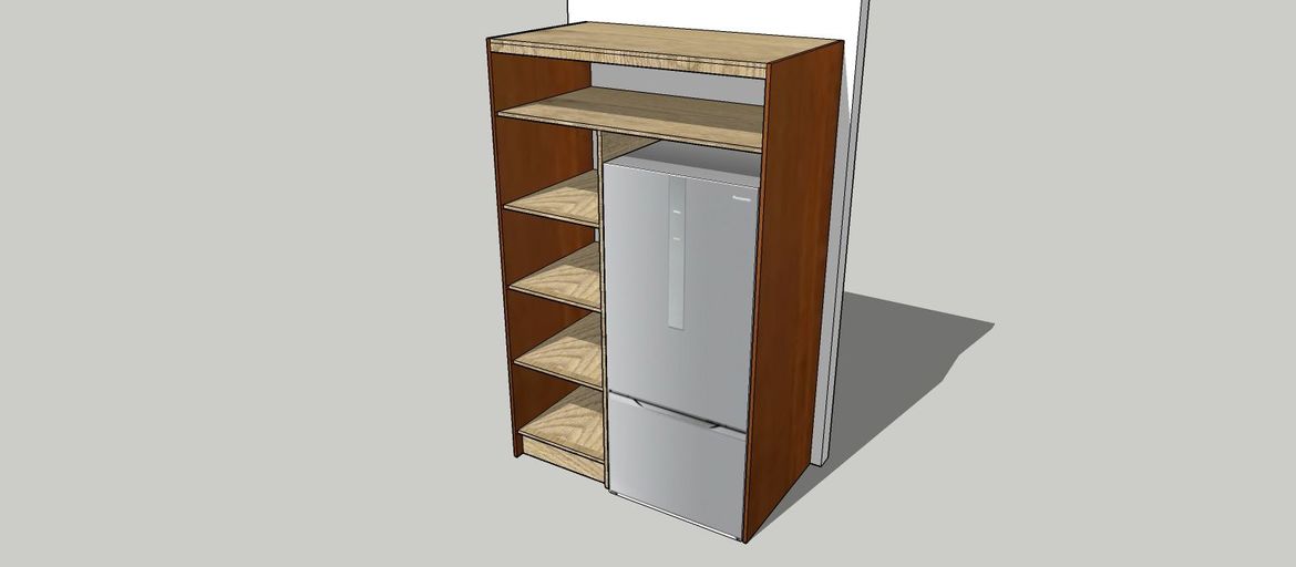

Matching doors in an established kitchen can be difficult. So our goal is to enhance or compliment the current set up without over spending on our capital. Using project pine panels you can do the following. You use a project panel that compliments the existing oak mahogany color of your door and create a frame for you to place sliding baskets. You can stain and varnish the panels until it is close to the color of your existing panels. Leave the panels as a natural color and clear coat it to create a firm contrast between your kitchen (daring I know, but not for everyone). Below are the drawings and the drawer! Enjoy!
Cheers,
Red
asoph1.jpgasoph2.jpgasoph3.jpg1 of these in each shelf, what do you think?1 of these in each shelf, what do you think?
