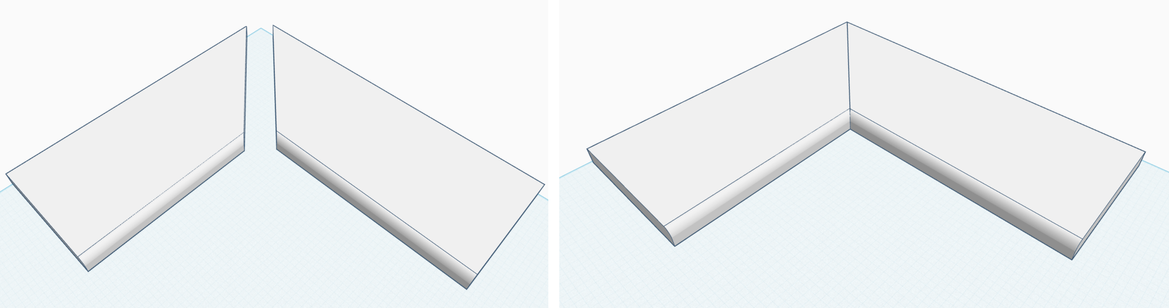

Oh,  they are laminate benchtops @JR2! Now I understand better.
For a mitre join, both your benchtops would need to span the full length of their walls. In the corner, they can both be cut at a 45-degree angle.
I've created a 3d render of a 28mm thick bench with a corner on the top edge. I can't see why a Mason's mitre couldn't be used in this situation.

Afternoon @MitchellMc  and @JR2
The second pair is what I had pictured in my mind. I wasnt too sure if the reused benchtops were exactly the same so figured the square join would be easy to line up.

Thanks Mitchell. Would you happen to have a close up of a render of what the edge looks like? Especially if butt joined?
Re: how to a corner join on curved benchtop with no masons mitre
It's a bit hard to show as the corner is so small @JR2. It will look something similar to the below. There will still be a tiny joint line, but nowhere near as bad as using the curved edge board.
