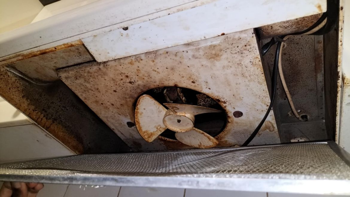

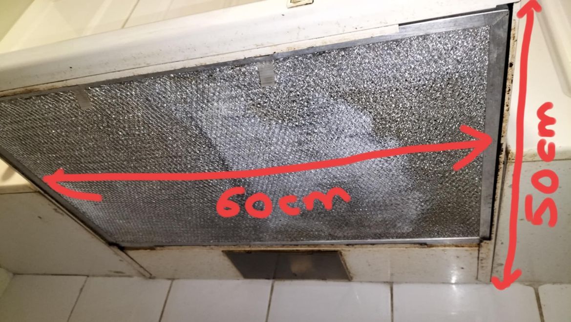

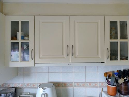

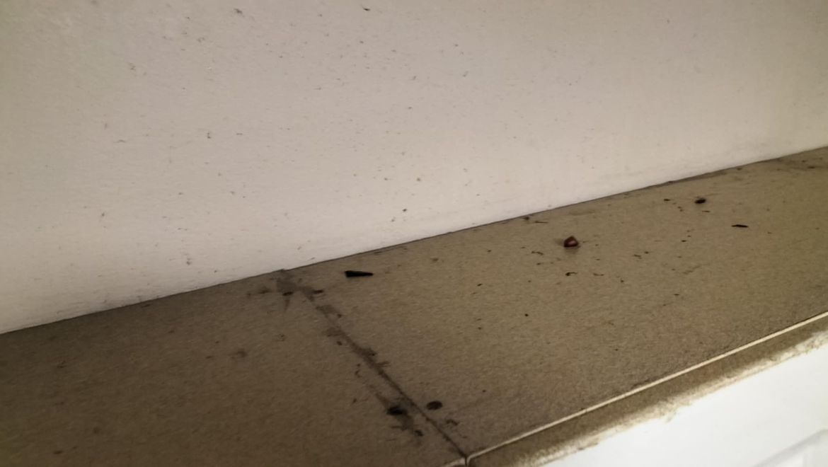

Hi there,

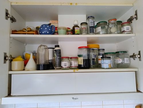

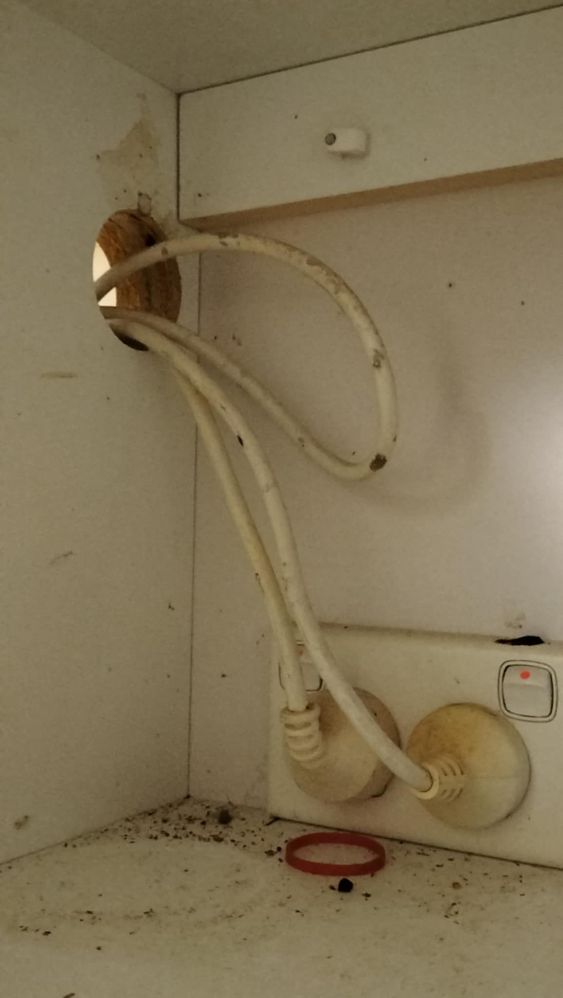

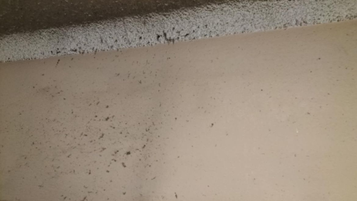

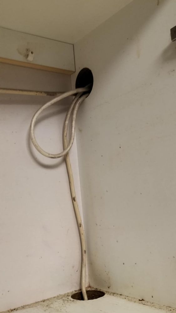

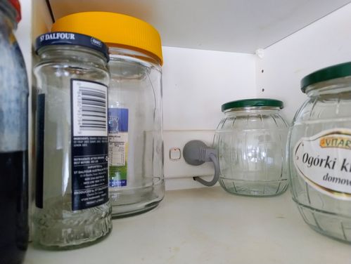

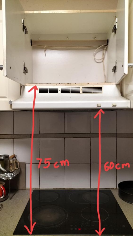

We have a very old model kitchen hood which doesn't have a vent out. All the cooking fumes are just blown into the house and the cabinets and roof are getting greasy and gunky as shown in the pictures below. We were thinking if the hood had a vent going outside then it would fix this problem. We have small vents on the wall near the window as shown in the photos. There is also a socket in the cabinet next the hood. Can we put a vent to the existing hood or do we need to replace then entire hood? Can you please provide a solution and if we need to change the hood, can you please give us some recommendations of what to buy.

  • There is also a socket in the cabinet next the hood - Good.

The cabinet has a bracing timber which might restrict airflow but we are OK because centre of vent hole is 79mm from the back.
On the existing hood mark centre and forward 80mm.

Unfortunately, as your existing rangehood is a recirculating type rangehood, you will have to replace it if you are hoping to vent it elsewhere
You'll have to replace the existing rangehood with one with a cowl to attach a duct to, such as this Bellini 60cm Stainless Steel Slimline Rangehood.
The range hood can then be installed, and the duct can be routed up through the cabinetry into the ceiling, where it will vent.
As you have an available powerpoint, this install won't require an electrician, but due to the need to get into the ceiling cavity and drill through the ceiling, you might like to consider contacting a professional, such as an electrician, for their assistance with the install.

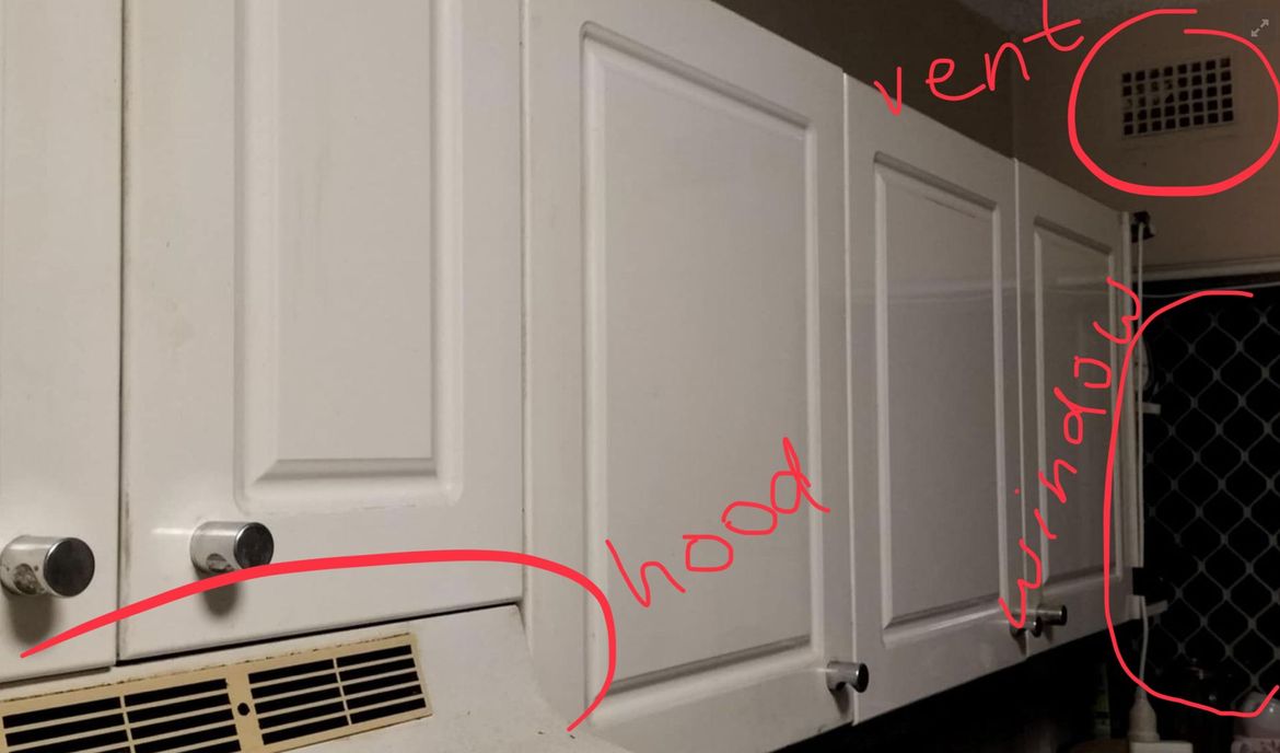

Thank you so much for your detailed reply. Great to see that you were able to fix this issue in your home! I forgot to mention that we live in an apartment so venting it out of the ceiling isn't possible for us. Is there a way around this like through the little vent holes on the wall on through the window?

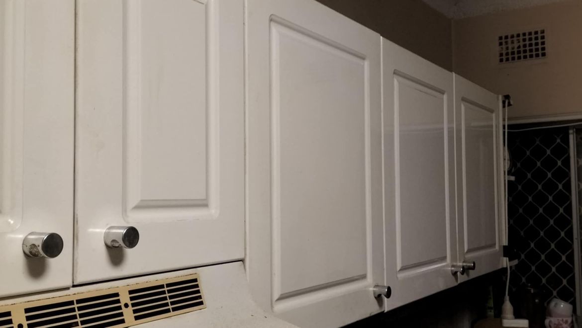

Sorry... can't create a picture in my mind of the vent holes and how they relate to the window.
Are both of those to the left of the rangehood?
Can you post some more photos.
Cheers

Here’s a photo of the vent holes and window relative to the hood

The wall vent cannot be used, any connection to that would very likely violate building codes.
The only option is the window.
The duct would run through to top of that cabinet and across the top of the rest.
Then we have to make a connection to the window.
One issue over that distance with a small diameter duct is back pressure which would tend to negate extraction.
Can we have a photo at the other end to see how we can connect to the window.
