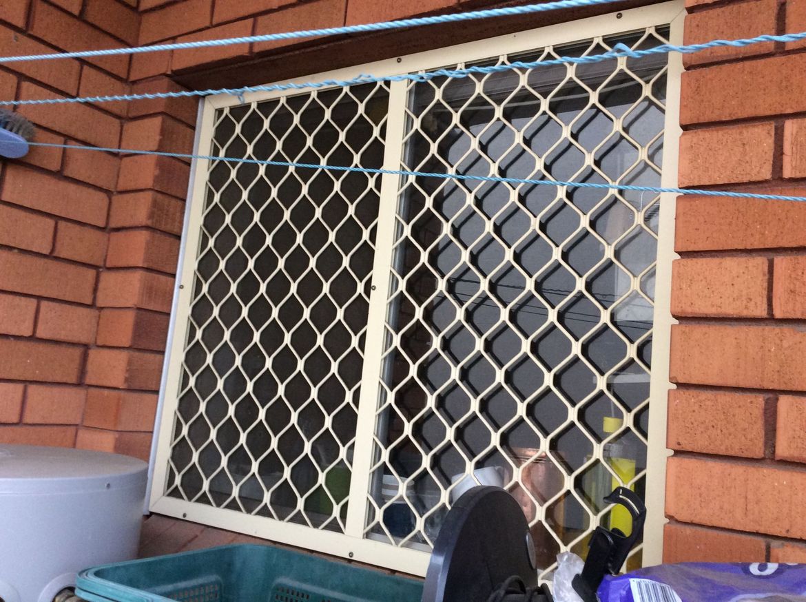

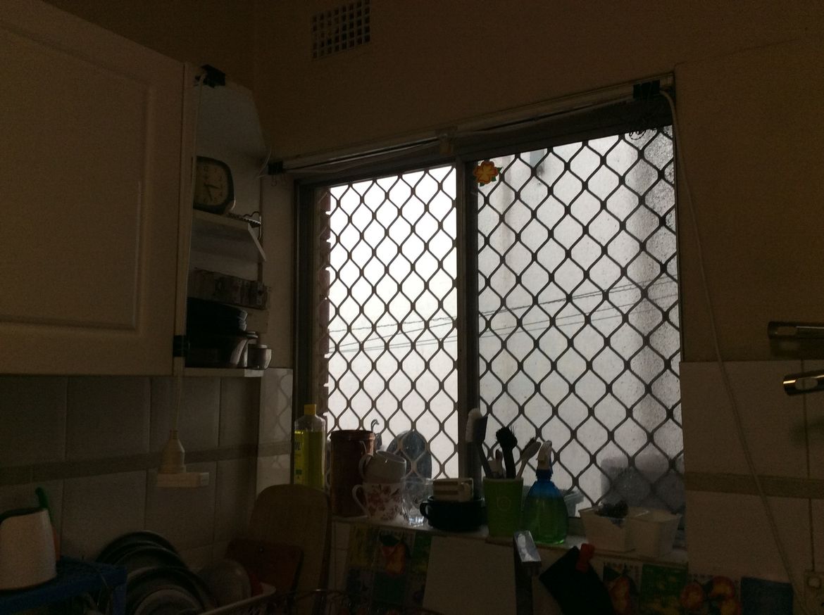

Thank you for your response. Here are photos of the window from the outside and the inside:

Window installation would be a eye sore and even harder than going through the brick wall, so I suggest the latter.
I will presume you have a strata tile and that brick wall does not fall under 'shared ownership of common areas, such as hallways and gardens'.
