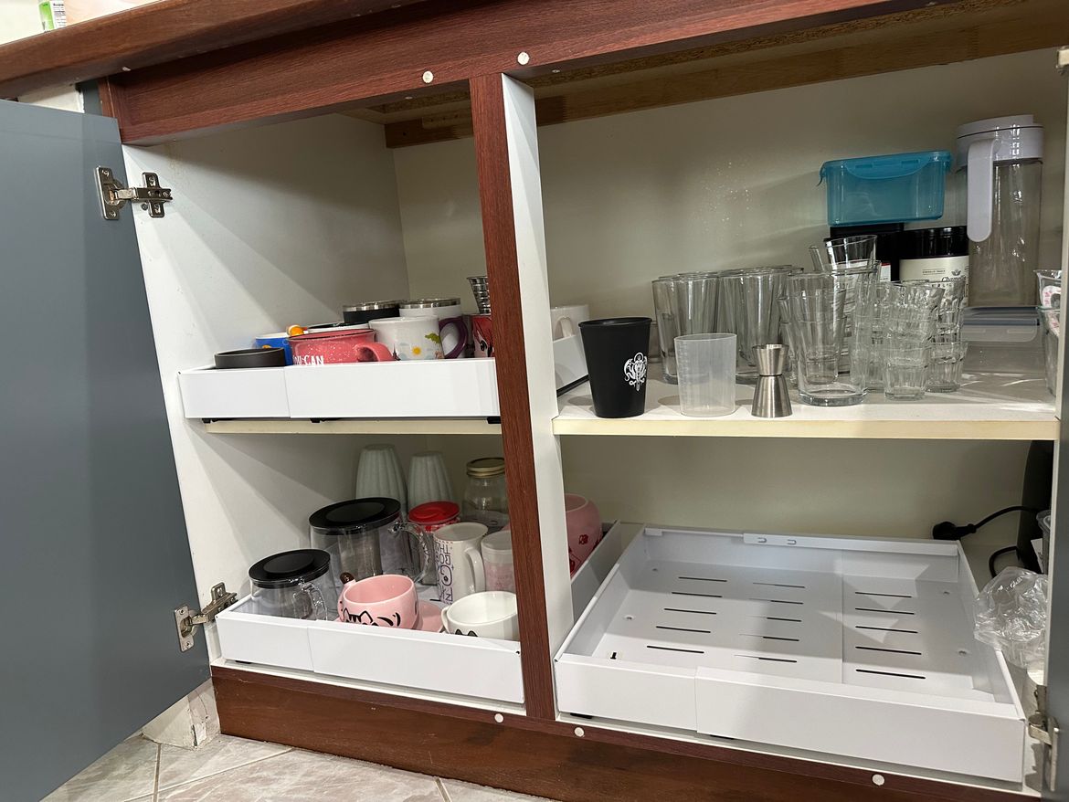

I am a complete DIY beginner, and I would like to add either a shelf or drawers above the first shelf to utilise my cabinet space better.
I had a look at this post https://www.workshop.bunnings.com.au/t5/How-To/How-to-add-drawers-to-a-kitchen-cabinet/ba-p/166846 but because my cabinet shelving stretches 3 doors, I don't have a side to mount the drawer rails to.

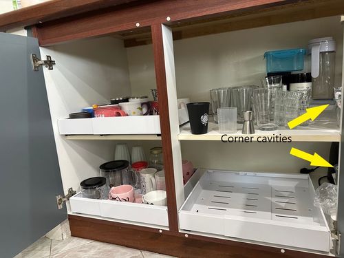

I have a question, are those corner cavities?
From my perch over here looks like you have three sections; Left door, Right door and Corner cavities.
I propose your only option for shelves/drawers in the first section (Left door) because if you go any further (Right door) you will lose all that cavity space in the corners. With 'DIY beginner' in mind I suggest you do shelves, top and bottom with a side on the right... and continue to use those trays.
BTW: Can you tell me where you got that bottom right expanding tray 🙂
Having said all that if you really want to do the drawer thing cut out the First door shelf and make a freestanding drawer unit that slides in there. Also do some searching and hopefully you will find a drawer flat pack that will fit that opening.

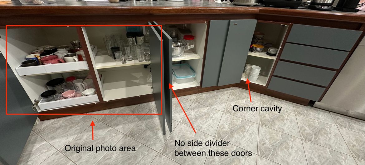

@JacobZ @Dave-1 Thank you so much for your replies and expertise, I will borrow a circular saw from a friend to cut the melamine for the dividers.
@AlanM52 Thank you for your comment, I've attached a better photo that shows more of my kitchen bench area to clear up any confusion.
As you can see below the set of 3 doors all share the same cavity, the divider between the doors is just a facade. The corner is in a separate section and has it's own divider. Like you said if I try to add a side wall to the corner I'll lose cavity space so I'm going to leave that one alone.
