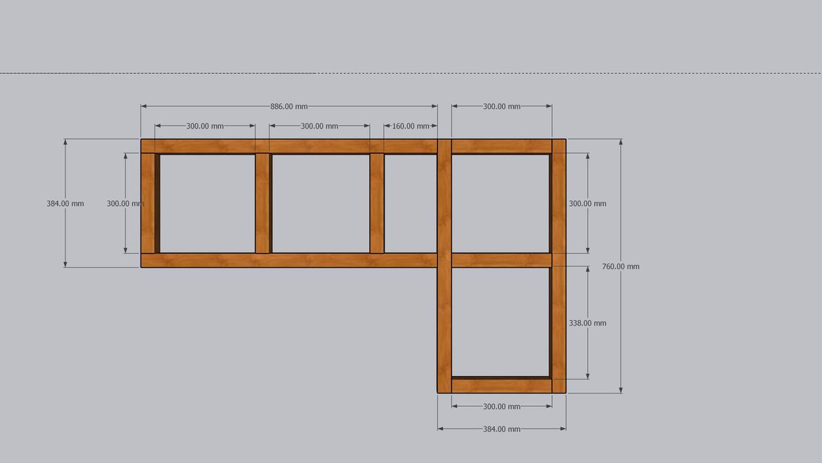

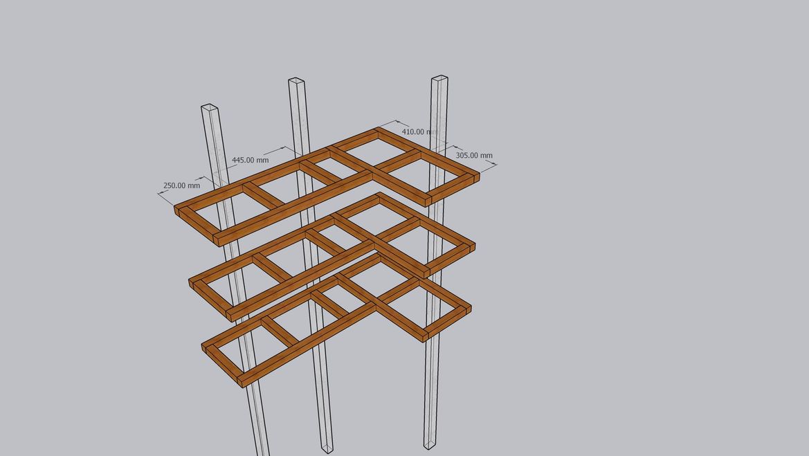

We want floating shelves and want your advice on my plans - mainly on the framing and strength.
I will be using Porta 42 x 42mm https://www.bunnings.com.au/porta-42-x-42mm-1-2m-dar-square-general-purpose-pine_p0021181 for all the framing.

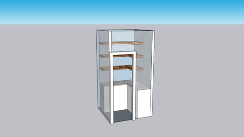

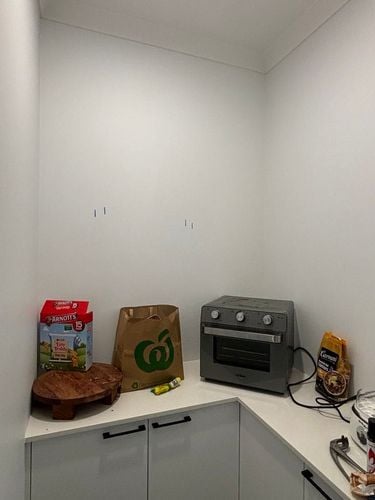

Current state of my pantry
Proposed pantry
Identified wall studs
Shelf Dimensions

Floating shelves can add a modern look, but given your intended weight load, here are some considerations to ensure strength and stability.
First, screwing into the studs is typically enough for support, especially with the 42x42mm framing you've chosen. However, since you’re looking to hold heavier items like appliances (20-30kg), it wouldn’t hurt to add some additional fixings into the plasterboard for extra stability, particularly in areas that may need reinforcement, like the bottom left corner of your shelf dimension image. This will help evenly distribute the weight and reduce any strain on the framing.
Your framing design looks solid, especially if it’s fully anchored into the studs. To attach the frame to the studs, I’d recommend using robust screws like these Zenith 14G x 125mm Galvanised Bugle Batten Screws. They’re designed for heavy-duty framing applications and should securely anchor your shelves to the wall.
For joining the frame itself, standard timber screws will work well. Zenith 10G x 50mm Galvanised Countersunk Head Timber Screws are a good choice, especially if you’re going for pocket hole joinery, as these screws offer solid holding power and keep a low profile. If you're using a pocket hole jig, follow any specific recommendations for screws, as pocket holes typically require specialised screws for secure and flush connections.
Regarding the weight load, 20-30kg is a fairly heavy load for floating shelves, as these are traditionally suited for lighter items. With the right anchoring, it may be possible, but for long-term durability, I’d recommend keeping the weight as low as possible or only placing heavier items on the lower shelves, closer to the support points.

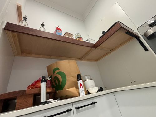

Just a little update on this. I went overseas and came back to start this project last week.
I went down a different route as I wasn’t 100% confident when I started this (there was just too much sag when I was putting the frame in). Originally had plans of using 42mm frame but decided on 30mm. This may have contributed to the weaker frame as I hoped to put 2 screws per stud but only did 1.
I had some particle board left over which I used to add a bit more stability to the shelves. I also used 36mm ply wood (gluing 2x 18mm together) for the frame no touching the walls.
There was a tiny bit of flex/sag where the shorter shelf corner had no support so I decided to add a bracket. I’m sure it would have been fine without but wanted to be safe than sorry.

Hi @deancarlo,
Nice work with your shelf, it looks fantastic.
The addition of a bracket on that leading edge was a good decision. Without a wall to support it like you have on the left, there's a lot of pressure on that corner that could cause issues over time. The bracket will definitely help with this.
In terms of heat protection on the underside of the shelf, you could try applying a heat mat like this Zeal Silicone Hot Mat Large to the underside of the shelf. I imagine there would still be some heat transfer, but it would certainly help to absorb and dissipate the heat before it transferred into the timber.
Let me know what you think and thank you for sharing the update.
