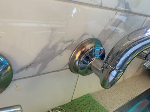

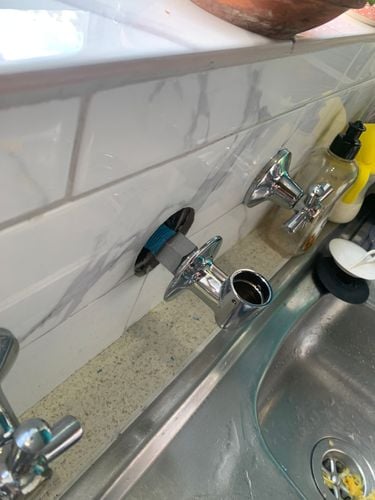

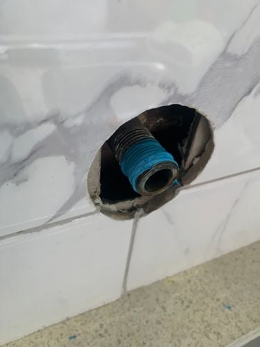

Hey, looking for a solution to a newly tiled kitchen splash back which has new brought the splash back forward approx 20mm and now the taps need extensions.
have found a solution to the hot/cold taps via this forum and have used kinetic pvc bonnet extensions

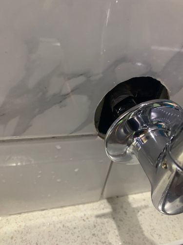

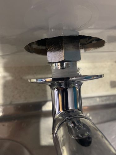

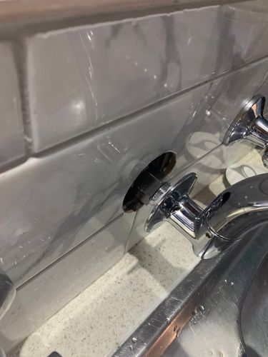

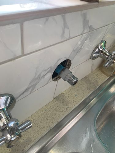

Not sure how to extend the tap itself now. We have brought a brasshards M&F extension CP 15x40mm extension but it brings it out too much and leaves a big gap between the splashback and the tap. Other option is to not use the extension and to just screw it into the tiles and apply some silicone however that leaves the risk of internal leakage going unknown.
anyone got any ideas ?
