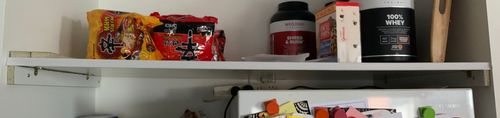

I just added a shelf above our fridge for extra storage as below. I used a particleboard 16mm thick
The size of the shelf is 1167x700, mounted to 2 cleats of the same material
We will be putting only lightweight items on it, however, I wonder if I should add extra support under the shelf to avoid it sagging
I’m thinking about cutting another piece of particleboard and putting it under the shelf between 2 clears making an H shape, does it work? Or is there a better way?

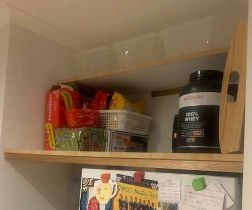

Hi @EricL,
It’s done. I made the supporting frame using DAR Tasmanian oak, with more pieces like you suggested, and covered the edge of the particleboard using 3mm plywood pine
Not perfect but I’m still pretty happy with the outcome. Have learned some new things from doing this
