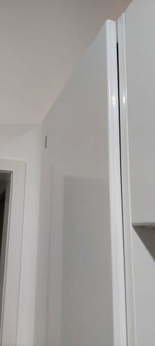

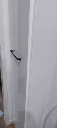

Just installing a new kitchen including a 450mm pull-out pantry and having a hard time getting it to close properly. The builder managed to get it fine, but once we start loading the shelves, it throws the alignment off and needs to be adjusted again. Is this an ongoing issue every time you change the weight distribution, or should it be a one and done?
I'd also like to know the weight capacity of the shelves, as the brochures show them loaded up with bottles and other heavy items, but this seems like it would cause alignment issues.
I've searched for videos on how to adjust the door, with no success, and the instructions that came with it are minimal.

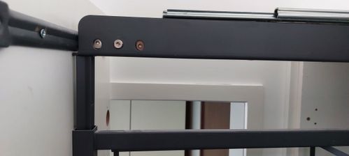

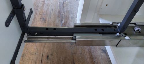

Yes I like the white too! Turns out it's significantly cheaper, so that was a happy accident. Unfortunately, my pull-out pantry is more like a drawer than a cupboard, so no hinges to adjust. There is a top runner and a bottom runner, and a few hex key adjustment options for the door that are very finicky. It's so frustrating that kaboodle has no videos for something that most stores seem to have at least one display of.

That is a way clearer set of instructions than those that came with the unit, but doesn't tell me anything I didn't already know, unfortunately! Knowing the name of the unit might help though (I tried finding it on the paperwork), so thank you.
Update: 5kg per shelf, max 35 kg for the unit. Which must mean the shelves themselves must weigh a total of 5kg.

I'm sorry to hear your pullout basket mechanism is not lining up. Since it is a newly installed kitchen, I suggest calling the installer back again as it is clearly still under warranty, and it should perform correctly when loaded. I don't recommend making any major mechanical adjustments to the pullout set at this point in time. Your kitchen installer is supposed to turn over your brand-new kitchen with everything in working order. That includes the pullout pantry when loaded.
If a major adjustment has to be made, it will mean disassembling the entire pull out set and the frame base will need to be moved further back into your pantry. But it could also be as simple as realigning the pantry door as the mechanism behaves differently when loaded.
However, if after the adjustments are made and the mechanism still does not work properly, please let me know.
