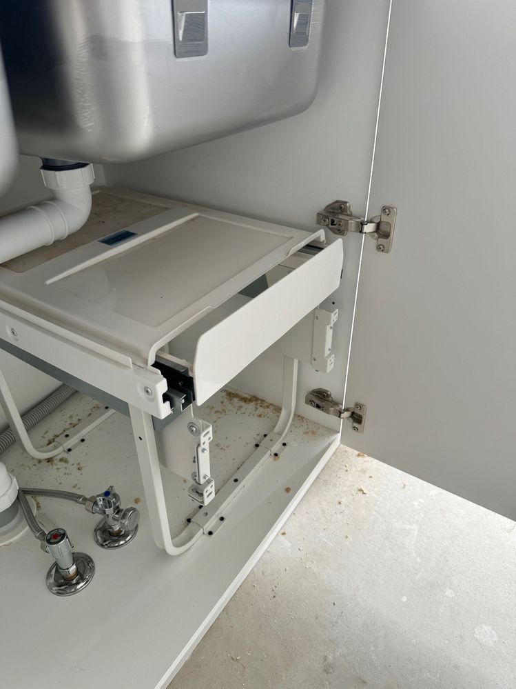

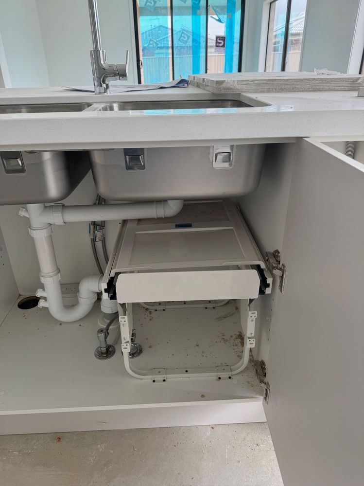

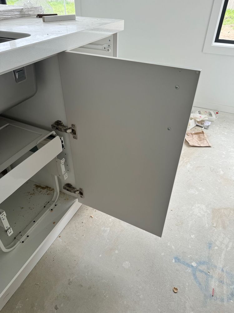

Thanks for your email. Please see the pictures of the bins that my builder has installed. Could you please let me know what type of angle brackets should I buy to attach the current hinge door to the bins? Thanks
Hello @bijujose
I have placed a picture of your pullout bin with yellow circles. The bracket is already attached to your bin and does not need new brackets. You just need to mark the position of the brackets on your door and screw the door to the pullout mechanism of the bin. Make sure to remove the hinges as they are no longer needed. If you feel that it is too difficult, I suggest engaging the services of a handy person to attach the door for you.

I noticed the brackets on the bins. Don’t we need similar brackets for the door as shown in the video guide? I was referring to those.
If the sliding mechanism attaches directly to the door, does the bin stay slightly open inside the cabinet?
Hi @bijujose,
I believe the video Eric linked to was intended as an example of a similar product's method of installation.
I don't have access to the Hafele installation guide at present, but what Eric has said about attaching the circled brackets to your door makes sense as the solution.
In its current location, yes, the bin would stay slightly open inside the cabinet, but it is likely possible to unscrew the frame, move it forward and then reattach it to the base of the cabinet to rectify this.
