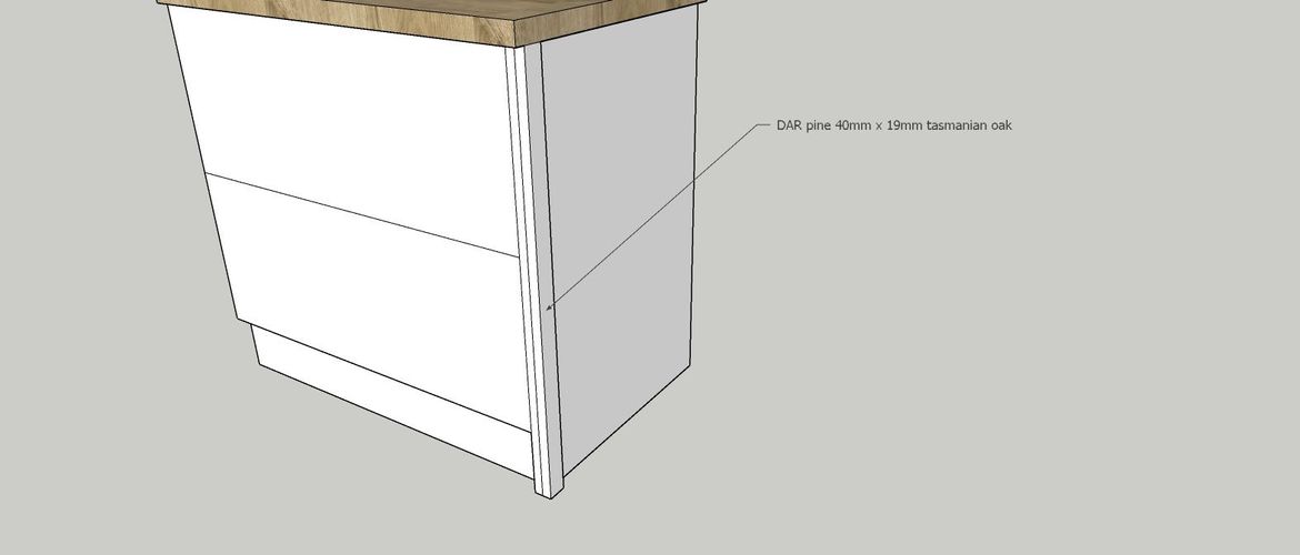

Welcome to Bunnings Workshop. Normally the gap is practical to allow for the ovens air circulation. How ever if you wish to cover this you can easily use a piece of dressed timber painted in high gloss to the same color as your doors and panels. This panel that you will attach to your kitchen will eventually turn yellow and discolor due to the intense heat of the oven when the air blasts out when opening the oven door ( this phenomenon usually takes a couple of years to occur ). You could attach some angled aluminum edging to the panel to protect it from the heat. Below is a drawing of what you could possibly do to cover the gap. I hope the suggestion helps. Perhaps Mitchell might have some other ideas when he returns.
Cheers,
Red
Please note : To be painted to the color of the cabinets.Please note : To be painted to the color of the cabinets.

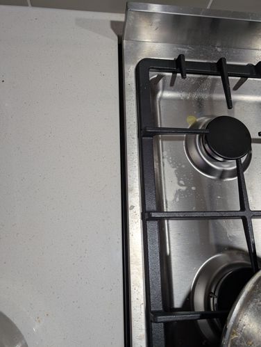

How do I fill the gap between stove and the bench top. Please see the pic

Hi @javedmohib,
It looks like the gap could be a bit wider than about 5mm, which would mean you'd have to push some Filler Rod into the gap to act as a backing to prevent your sealant from falling through, before applying some silicone over the top.
You can then use this Sikaseal Appliance Silicone Sealant to seal the gap.
Check out How To Silicone a Gap for some guidance on the application process.
