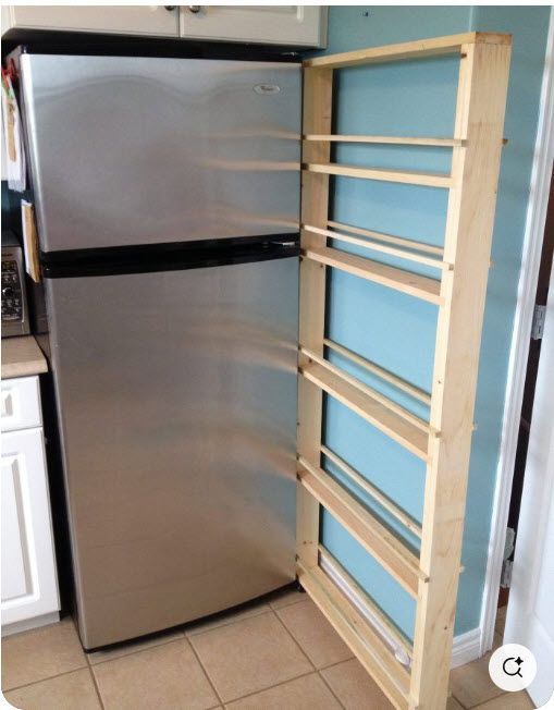

I am planning to build a spice rack similar to the one shown in the attached picture. Please can you confirm which wood and tools/screws required.

These slimline pull-out spice racks have been a very popular project on the Bunnings Workshop community ever since @DIYology shared the first one.
The step-by-step guide How to build a slimline spice rack has everything you need, including a full list of tools and materials. Please let us know if you have any questions about the steps in the guide. We look forward to seeing your project completed.
