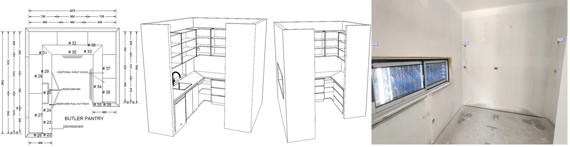

Below is my U shaped openshelf pantry, I want to corner mount the LED channel by screw & stick LED under overhead cabin bottom edge backside.
3 power points are added for LED strips by electrician in 3 corners as in the 3rd image.
1) how much length of LED channel to buy
2) how many drivers required her to cover the full U shape of pantry
3) how to hide the drivers as I don’t have doors in overhead cupboard. Is it possible to hide in wall cavity
4) how to pass the cable thru open shelf in corners?

Thank you for sharing your question about LED lighting. I propose having a look at the Arlec 10m Grid Connect Smart Sound Sync Strip Light or the Arlec Grid Connect 10m Smart CCT Strip Light. Both are colour adjustable and can be cut down to length. Both these units can be plugged straight into 240V and do not require special drivers.
The wiring is small and can be easily hidden by running it behind the cabinet. I suggest speaking to your electrician regarding hiding the wiring. Please show the LED lights to your electrician before you make any purchases. The best part is both units can be controlled by the Grid connect system.
