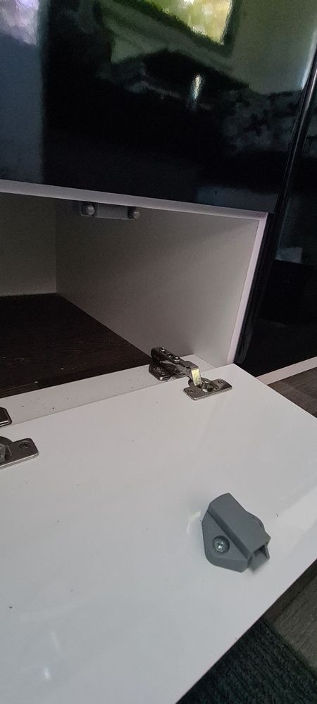

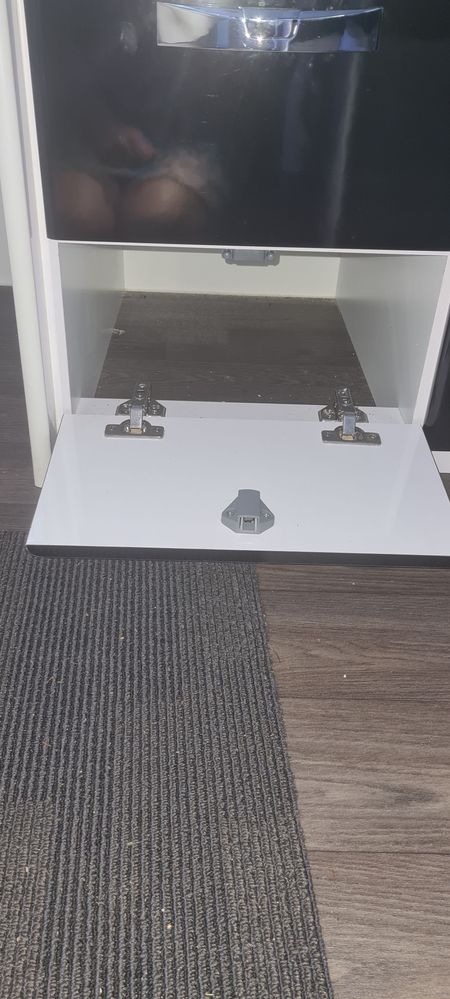

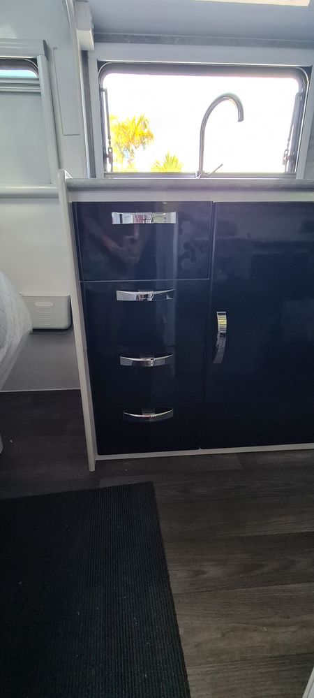

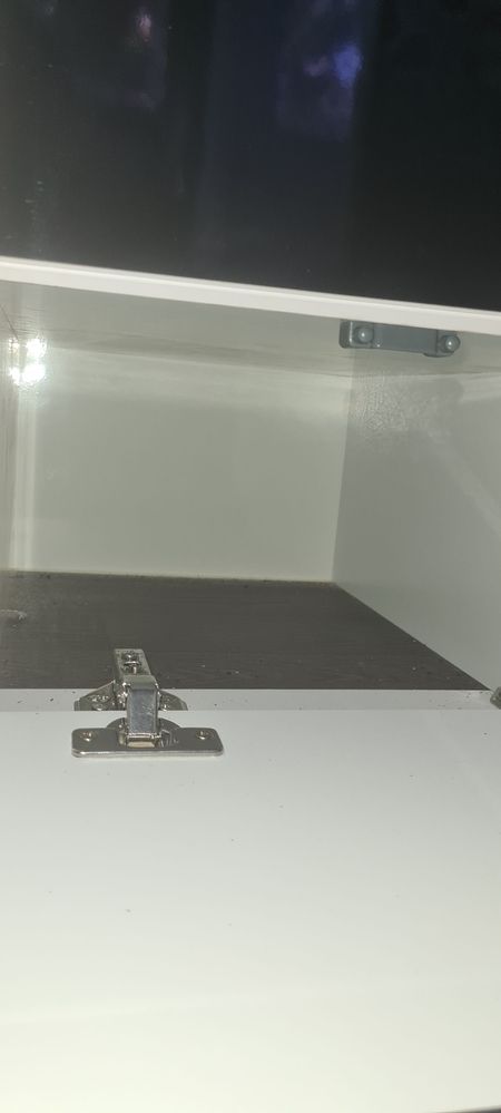

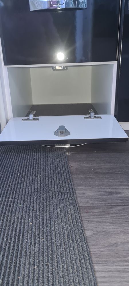

At the moment my caravan has 3 draws and then the 4th compartment under these looks like a drawer but is not. It is just a flip out front with a deep cavity. Can someone please guide me as to how I can put in draw runners and turn it into a draw? I know NOTHING about this sort of thing so I need clear direction!
The internal width of the cavity is approx 38cm and the depth is approx 50cm.
Please see my crappy photos attached.
Thanks!

Excellent thanks! I think the trickiest bit will be putting the runner in the cavity and making sure I don't have the draw attempting to slide in too high or too low!
Hello @HelYeah
In order to keep the drawer properly spaced use some timber pieces as spacers. You can do the same with the drawer runner to have them at a uniform height.
