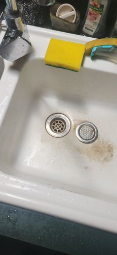

Hi I have an old style sink drain with the ole waffle stomp design. I'm wondering how hard it would be to convert it to one that takes those deeper collectors than you can push down to plug the sink

Can you advise whether you are looking for a popup waste or a basket waste?
As long as the plumbing connections are in place, it should be a simple case of unscrewing your current waste, purchasing a new waste that is compatible with your basin and pipes and screwing it in. If any alterations need to be made to the pipes beneath the basin, then you'll need the assistance of a plumber.
Basin wastes are held in place by a brass or PVC nut on the underside of the sink. Unscrew this nut to remove the waste. You can then bring it in-store with you to match up with a new waste in your style of choice ensuring that it is compatible. You'll need to ensure the thread on the bottom of the waste is compatible with your current pipes and the flange around the top of the waste will fit inside the rebate of your basin.
Assuming no alterations need to be made to the pipes, you should be able to simply reverse the steps you took to remove your current waste.

Often the easiest way to match things up is to put them right next to each other and compare.
As I mentioned, the main measurements you'll need to match up are the outside diameter of the thread at the bottom of the waste and the flange at the top.
If you could advise which style of waste you want and these measurements, I can do my best to find you a suitable replacement.
It looks like your basin sits in a cutout on your benchtop, so I would be very surprised if you could find a replacement that fits exactly in the cut-out. If you replaced the benchtop, your options would open up greatly, but obviously, that would increase the cost of the project.
