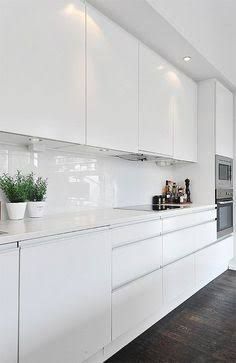

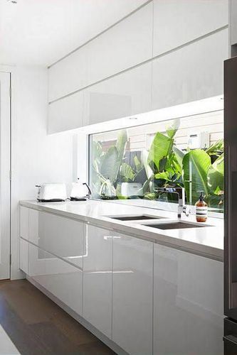

  Hi everyone, thanks for having me here. We will move in our new house very soon but need to do some small renovations and one of this is the kitchen cabinet, the recent owner got the 14 pieces set which is very modern and especially in gloss white engineering wood, look like pictures below. I would like to ask for advice on how to get rid of the glossy effect and paint another color, would be much appreciated if anyone used to do the same and share the experience.
