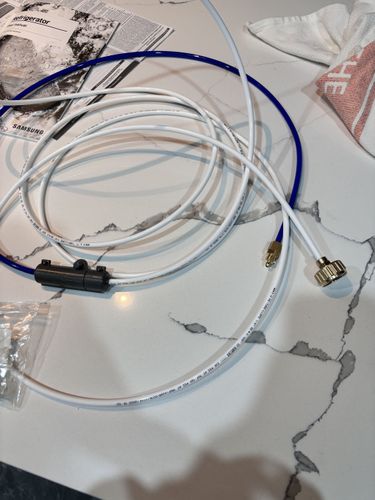

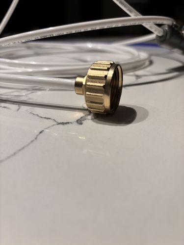

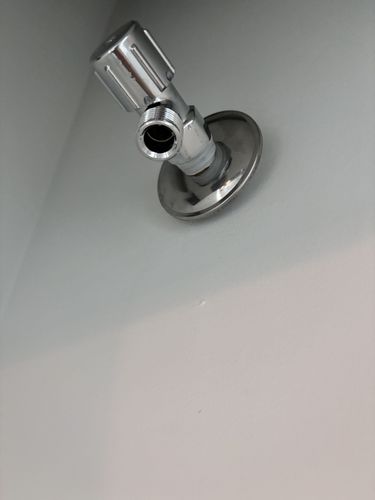

Hey, I'd appreciate some help with how I can fix this connection issue. I have the adapter supplied from Samsung which connects to the tap in the wall. It is however too big (20mm) for the water outlet which is 15mm. Is there something I can buy to make them connect successfully? And do I need any other tools to help?
This is the existing water outlet in the wall which is 15mmThis is the existing water outlet in the wall which is 15mmfridge 4.jpgThis is the 20mm that doesn't fit on the water outletThis is the 20mm that doesn't fit on the water outletfridge 6.jpg
Re: I'm having trouble connecting my new fridge to water outlet in wall.
Hello @Sam123
Welcome to the Bunnings Workshop community. It's sensational to have you join us and thanks for sharing your question about your fridge water outlet.
I suggest using a Brasshards 20 x 15mm Chrome Plated Brass Bush on the tap outlet in order for the fridge fitting to work. Please make sure to use plumber's tape on all the threaded fittings. The fridge fitting may have come with a rubber washer, please double check the packets that came with it and don't forget to install it as well. Remember to observe all the fittings for the next 24 hours to make sure that it is not leaking while it's in operation.

My apologies if the link is not working. Please try this one - Brasshards 20 x 15mm Brass Threaded Hex Reducing Bush LF. Please make sure to follow the installation instructions that came with your refrigerator unit.
