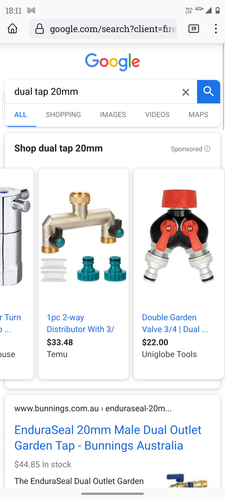

Hey Eric, thanks for the answer. The problem is with those dual brass is, the are not compatible for kitchen faucets and I couldn't find any aerotor adaptor for connecting faucet to those dual systems.
They are all seems to be eligible for garden taps or washing machine taps. Any suggestion?.
