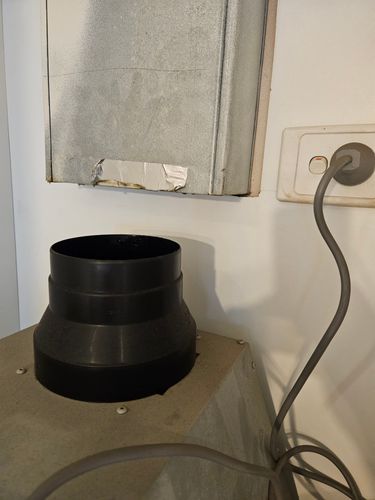

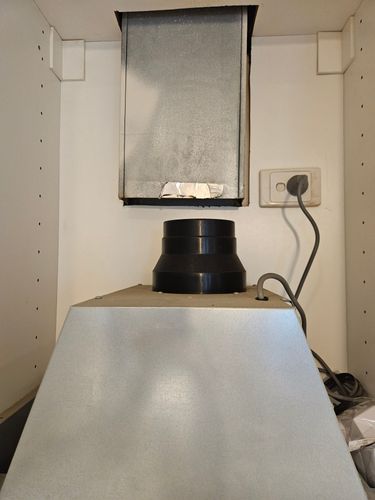

Would love the community's thoughts on the best way to connect a circular range hood outlet to a rectangular exhaust duct. As you can see in the photo they are very close to each other so I imagine the first step would be to cut the duct back a bit.

My apologies, I found it strange that I couldn't find something designed for this purpose as it is somewhat common.Upon further investigation, I've found this Deflecto 130 x 290mm Rectangular To Round Rangehood Adaptor which can be ordered through the Special Orders desk of your local Bunnings. Would these dimensions match up with the ducting you have installed?
If they did, as you have said, the ducting would need to be cut back to allow this adaptor to be installed and then attached to the rangehood with a suitably sized flexible duct.

I think @JacobZ has nailed it in his second response 🙂 You will probarly need to do some adjustments but I would suggest to draw up a diagram of how things are currently sitting and then go into the special orders desk. They may have parts that are closest to the spacing for the flu and the circular top of the range hood.
Other then that I was going to either suggest a local fabricator of sheet metal or buying some Metal Mate 0.5 x 300 x 900mm Plain Aluminium Sheet - 300mm as it comes in various sizes and make a joining piece to the top of the hood. I would suggest to do away with the circular section. You could actually block of part of the hole with a flat piece of sheet metal.
