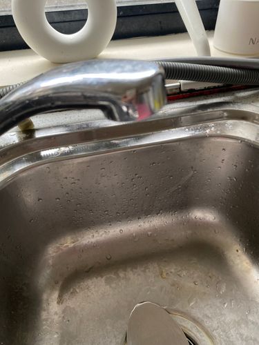

I have a countertop dishwasher which I had connected using a switch faucet adapter as shown in picture but it broke within few days.
Do you have anything similar to connect to the kitchen tap so I can run the dishwasher and also use the kitchen tap.
This helps in not connecting and disconnecting the dishwasher everyday.
I used a 1/2 to 3/4 inch connector  to this faucet adapter so the dishwasher hose can fit.

Welcome to the Bunnings Workshop community @gowsiriguppa. It's great to have you join us, and many thanks for your question about connecting a dishwasher to a kitchen tap.
Unfortunately there are no compliant adaptors that I am aware of. This is due to dishwashers, including benchtop versions, requiring a hard connection to plumbing work. As odd as it seems, benchtop dishwashers are designed to have their hose run through the benchtop or cabinetry to a connection under the sink as per their installation instructions and not to a kitchen tap.
Regulations on compliance with these types of adaptors have changed recently, but you might like to check out this discussion: Benchtop dishwasher tap connections. It's best to check with your local plumbing authority or professional and home insurance supplier before deciding on how to hook up your dishwasher.
