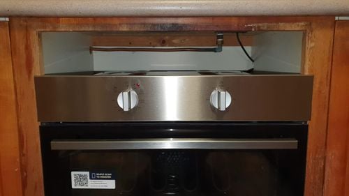

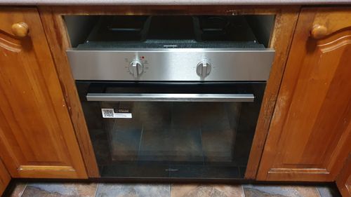

I have recently purchased a new oven which is shorter than my old one. I wish to lift the oven so that the gap is underneath the oven rather than on top then use some sort of panel to close it up.
Does anyone have any ideas on how I would go about doing this?
Photos attached.
Much appreciated.
Hello @thanh22
Welcome to the Bunnings Workshop community. It's fantastic to have you join us, and thank you for sharing your question about covering the gap in your oven base cabinet.
I suggest having a look at your old oven and see if there were timber legs attached to the bottom. If there were, I suggest removing them from the old oven and using them to increase the height of your existing oven. Ideally, the oven must have a gap both at the top and bottom of the unit for ventilation. I don't recommend pushing the unit all the way to the top of the cabinet.
However, if there are no timber legs, I suggest having a look at 70 x 35mm Framing MGP10 Untreated Pine 2.4m as possible legs for the oven. I suggest having a look at your oven manual so that you can find out where the ideal position is for the timber legs. In regards to the oven front panels, I suggest using Dressed Pine Timber. I recommend double-checking your measurements and choosing the panel that is the closest to the size you need.
I've placed a sample sketch below to give you an idea of how the timber is supposed to be positioned. If you have any questions about the assembly, please let me know. The measurements I've placed in the sketch are for reference only, make sure to adjust them to your needs.
Be advised that your oven is now a live-connected electrical appliance make sure to turn off the power to the unit before you start touching or moving it. If you are unsure of the power switch location, please speak to your electrician before making any changes. Make sure to wear proper safety equipment such as safety gloves, goggles and a dust mask when working on your oven cabinet.
