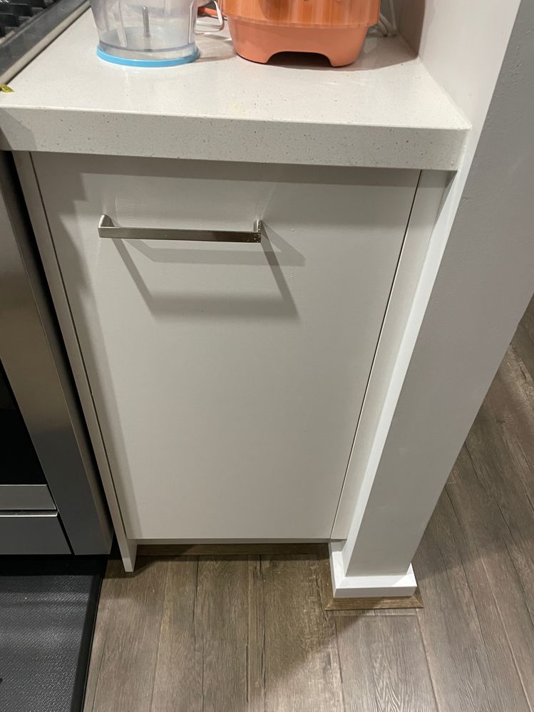

I have a kitchen cabinet 730mmx380mm (door dimensions) and i'd like to convert it to a pull-out bin.
Any recommendations will be helpful.

In my case, I am an absolute newbie at this (have some drilling, putting screws experience) and I'd appreciate if I could get drawings like you shared in the linked post for the cabinet I have.
Also, does bunnings cut MDF boards when i buy it from there?

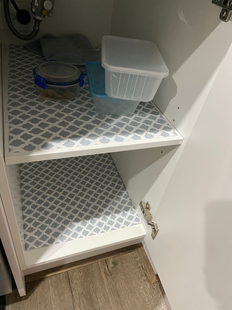

Dimensions of the door: 730mmx380mm
Dimensions (inner) of the cabinet : 650mmx353mm
Because of the gas pipe, usable depth would be 380mm.
Looking forward to your response.
