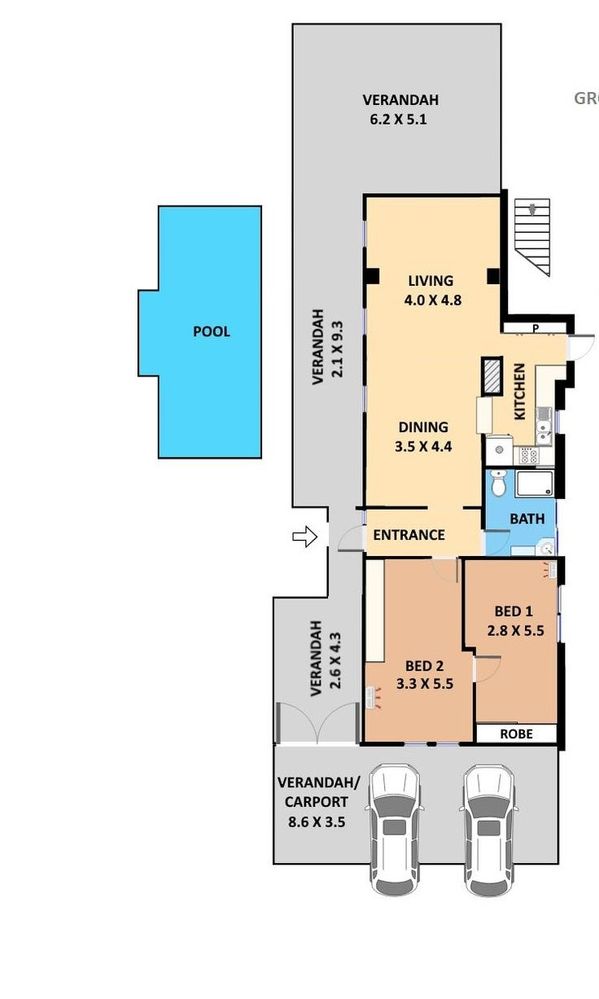

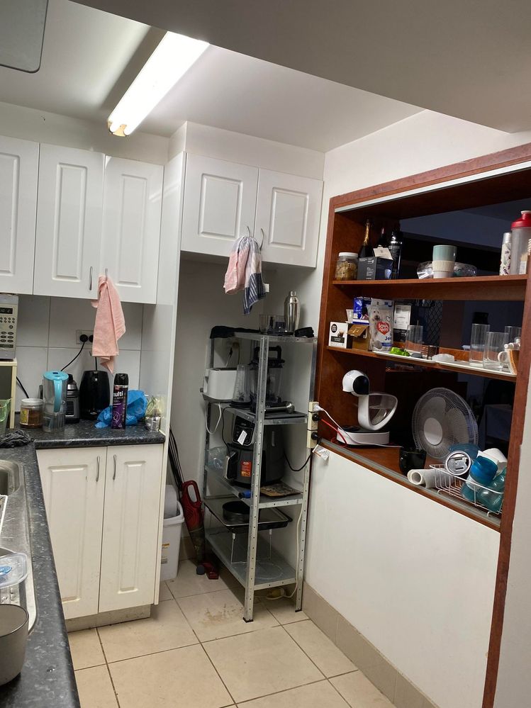

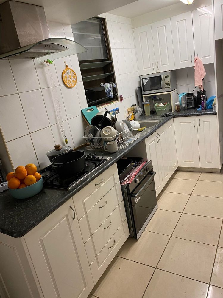

Hi everyone, I'm new to Bunning and just read some posts recently regarding house reno and am glad that most of them have had their great advice from Bunning experts and communities. I'm planning to reno my kitchen as below pics, about 2.5x4m (approximately), currently, it is very small and difficult to manage or do my cooking. Are there any ideas on how could I improve this to be more spacious? And I also want to change the flooring, benchtop, splashback, cooktop and cabinets, etc... to bring a new look to this kitchen. I'd love to add an island if the space allows getting more spots for preparing food and open space and get air from the dining/living to the kitchen if possible.
Appreciate all advices/ideas contributed.

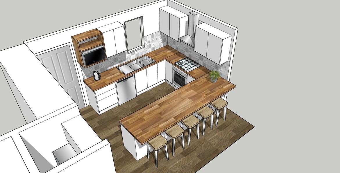

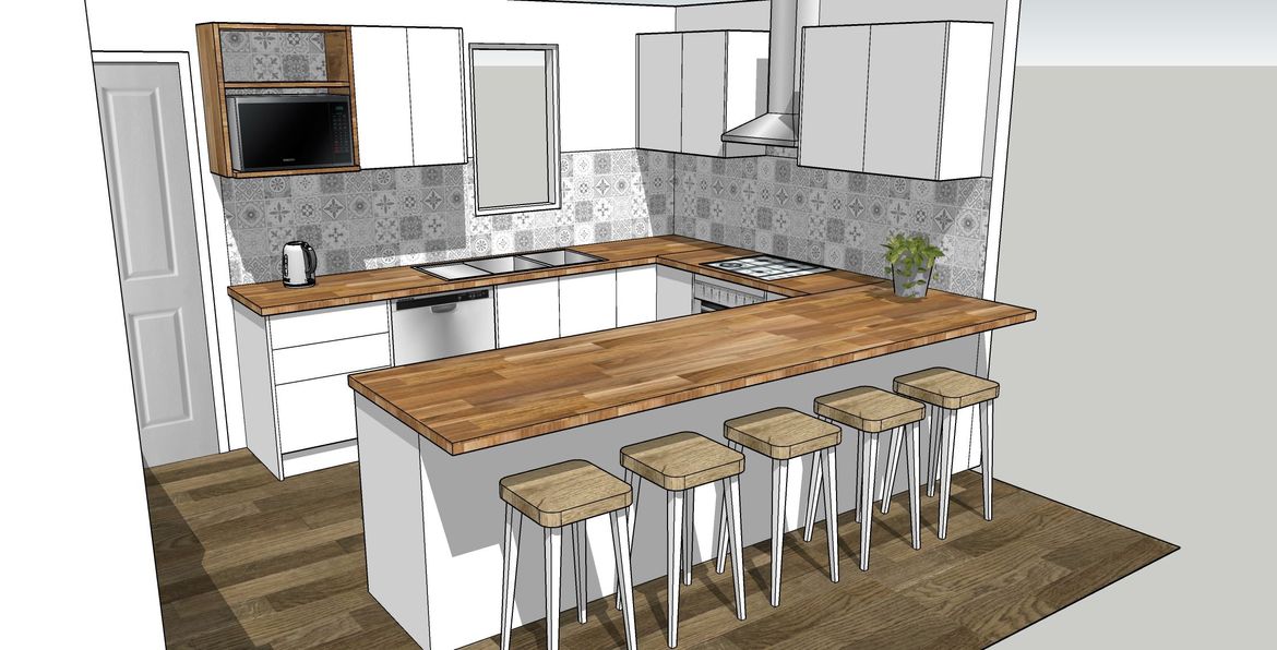

It looks like you could quite easily open up the space by removing that shelved wall (if it's not weight-bearing) and encroaching on the dining area slightly with the island. Check out this helpful guide on How to plan a kitchen renovation.
If you're lucky, your cabinetry carcasses might be able to have new doors used on them to update the look. However, that will only work if they suit available sizes. You could look at moving the stove and oven to the island, which would give you more room to maneuver.

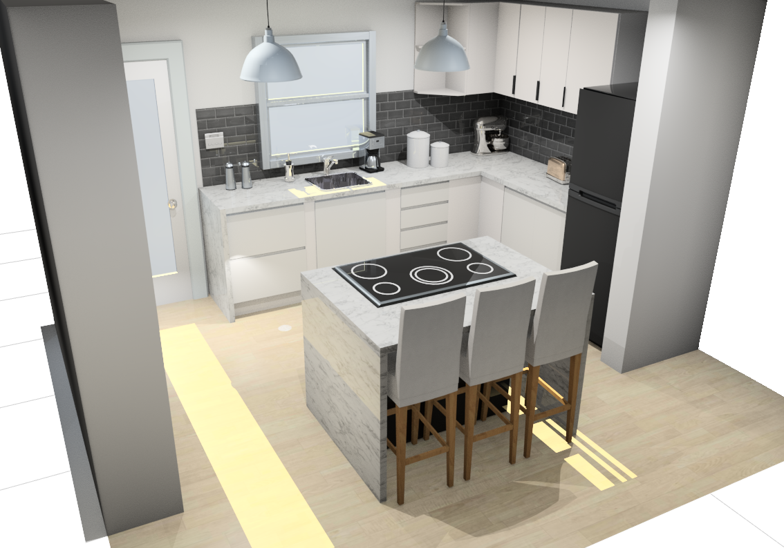

I've added a rendering below of a possible solution. Let me know what you think. I'll also mention one of our knowledgeable members, @redbournreno, to see if they have any thoughts.

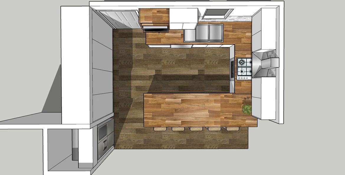

Hello @Giselle

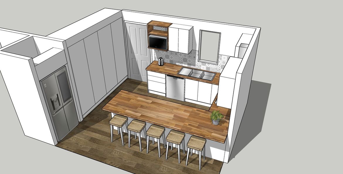

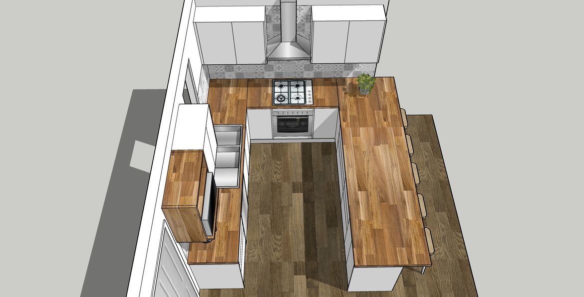

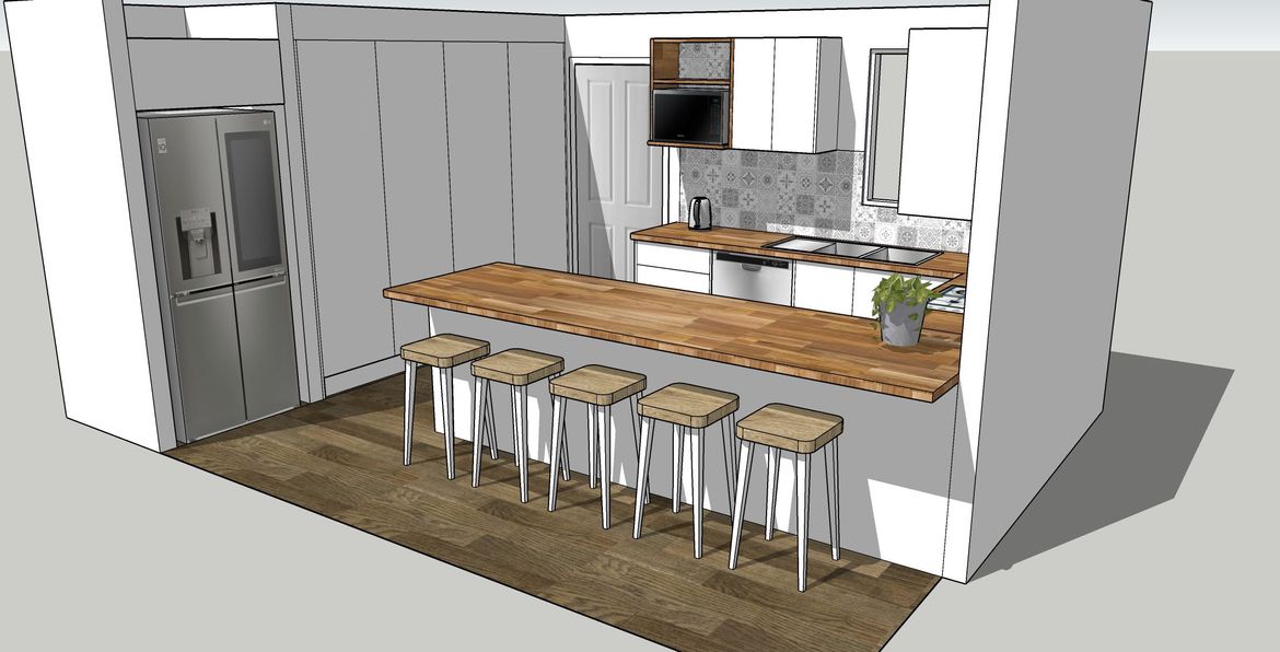

It's fantastic that you've received great advice and an excellent render from my colleague @MitchellMc. Just to add to the ideas already suggested, I recommend removing not only the shelf wall but the wall for the fridge as well. This will open up your kitchen and give you maximum prep space. All the appliances you have will now be able to be put into a cupboard or a drawer.
I've moved your microwave to the other end so that there won't be any fight for space in the morning. I suggest placing the kettle and the toaster in the same vicinity as well. I've placed as many drawers as possible in your cabinet lineup, but please don't hesitate to tell me if you wish to have a different setup. I've also put in a canopy rangehood to save on cabinetry.
At the moment I'm not aware where you've relocated your refrigerator, but I suggest putting it next to the pantry. If you can provide us with a photo of that side of the wall, we'll know whether my idea will work or not. Please have a look at the sketches and tell us what you think.
If you wish to see it in another configuration, please let me know.

Kitchens can throw up a lot of challenges and do require quite a bit of thought. You need to identify your budget at the start too. Both layouts suggested will work ok, each have their plus and minus.
@EricL one has a lot of cabinetry and do will be more expensive but WOW what a fantastic big and functional kitchen you will have in the end. The negative is walking in the entrance and maybe the fridge will be too obvious in that location?
@MitchellMc suggested layout is packed with value. Avoid having your cooker on the island bench though. I'd suggest putting it to the left of your fridge. But space will be tight for compliance, so see if you can move the wall out to move the fridge over to the right more. That will also create a gorgeous useful nook near your entrance for storage and display.

Thanks alot for fanstatice drawing idea for my kitchen. However, my concern is the wall on the right hand - opposite of the cooktop might be unremovable I believe, it is my headache as I couldnt move it and get some space for my kitchen. Any idea you think?
