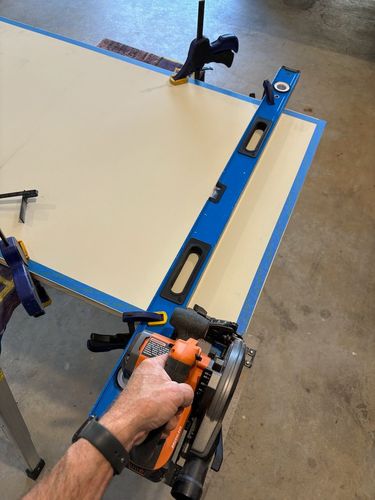

I have performed these cuts many times on Kaboodle panels.
1. Lay the board upside down on saw horses or similar with the face on the side you're starting your cut from. Ensure the end to be cut off is supported near the cut and clamp it.
2. Measure and mark your cut line.
3. You will now either need to setup a fence on your circular saw, or setup a cutting guide like the photos. This was a door being trimmed down but the process is the same.
4. You will need a circular saw blade of 40 tooth or greater.
5. With the power disconnected, adjust the saw's height so the blade is about 5mm deeper than the thickness of the panel. So about 25mm deep.
6. Wear a dust mask and eyewear as the cut causes a lot of fine MDF dust.
7. Position your saw ensuring the blade isn't touching the panel, and slowly make the cut. Slow down towards the end. If it's a large offset, have someone support it carefully so it remains flat and doesn't pinch the blade during the cut. And remember to perform the cut so the line is just left on the good side.
You should be left with a very fine clean cut.
Nailbag.
