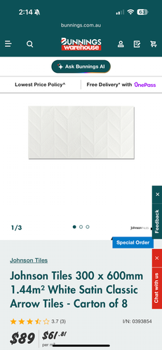

We are looking at ordering the Arrow Classic White Satin Tiles [pictured] to tile a kitchen splashback.
We have three PowerPoints that we would need to cut the tiles to fit around if we get them. What would you recommend that we cut these particular tiles with and how would we go about cutting them to fit around a PowerPoint without them breaking?
