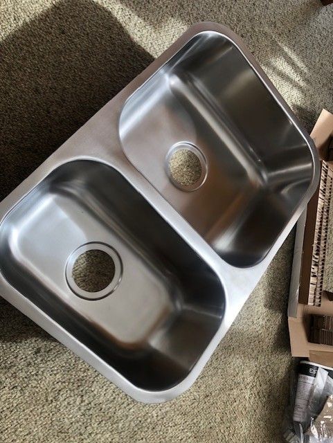

Hi I bought this kitchen sink from Bunnings (Estilo Stainless Steel 1 And 3/4 Bowl Sink), just wondering if I could drill a tap hole on the sink. If so, which type of drill bit would be suitable.
Thanks in advance.

I suggest using the Sutton Tools 32mm TCT Holesaw. They can be used for machine or hand drilling, and are suited to cut steel, stainless steel, aluminium, fibreglass, chipboard, plastic and other abrasive materials.
Please note that the sink must be firmly clamped to prevent it from moving while you are drilling through it. Make sure that there is a timber piece under the sink lip where you are drilling into. This will prevent it from sinking or warping.
If you're a bit hesitant to drill into the sink, I suggest engaging the services of a handy person that has experience in drilling into stainless steel. You can post the job onto Hipages or Airtasker.
