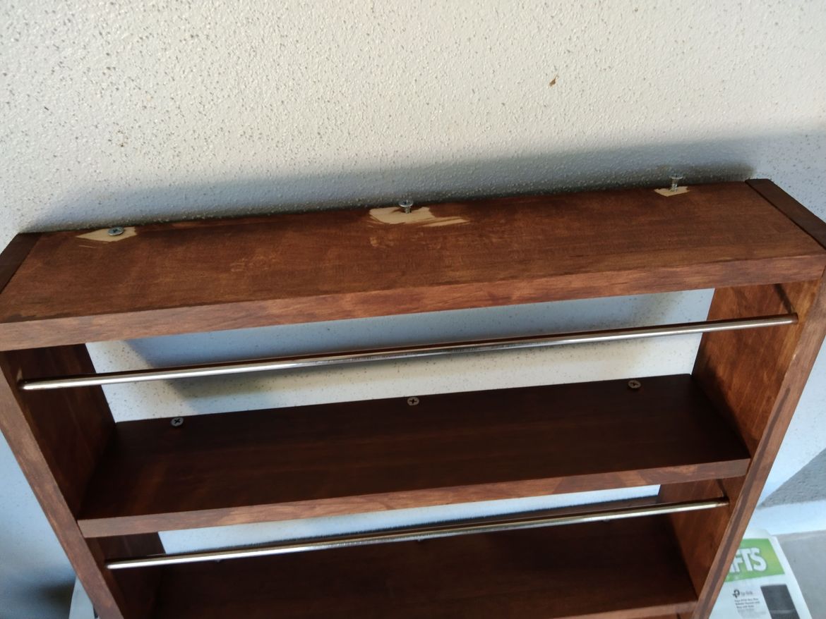

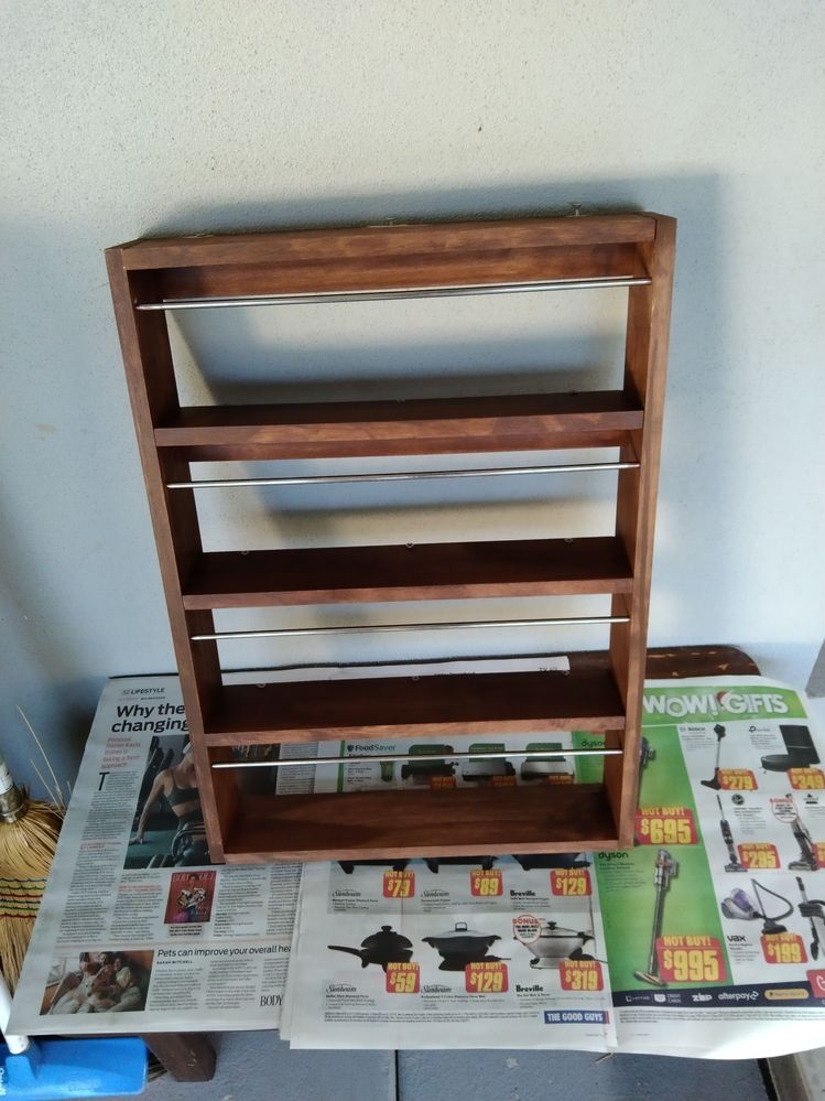

Hello, I've included photos.
https://www.bunnings.com.au/kit-out-timber-spice-rack_p0252056?store=8180&gad_source=1&gclid=Cj0KCQi...

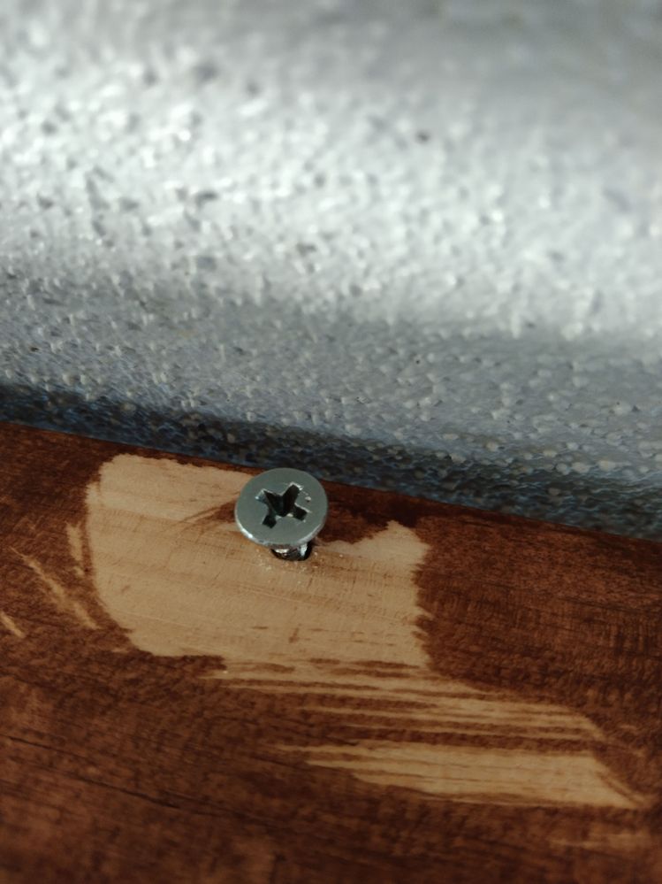

I'm not a handyperson so don't have a drill set. I'd rather not have to buy one if there's an easier solution which isn't expensive. I tried hammering a nail in to provide a pilot hole but pulling it out warps the wood. The box says you just need a Phillips screwdriver! (The spice rack is upside down to show the screws that it will be sitting on, so they have to be flush). Thanks.

The only way I am aware of creating a pilot hole without a drill is to do as you have and tap a nail into the timber.
I'd try removing the screw as this may bring some material from inside the hole out with the screw. This will open up some space in the hole that could help the screw drive deeper into the timber.
Putting some wax on the thread of the screw can also help the thread slide through the timber more easily. You can scrape the thread of the screw on a candle to collect some wax and then screw it into the hole.
Some gloves would also help you grip better so you can apply more torque to the screwdriver.
If these options fail, unfortunately, you'll likely need to use a drill.

Hi @LorenClayton
@JacobZ  has good advice.
I would  like to chime in with some extra  ideas.
First  take all the screws out.  All you need to  do is take out some wood material so the screw head  sits flush.
A tiny wood working excercise given you limited  tool set todate.
Best  method .  Safest   First use your philips  screw driver point as a  mini wood working tool and twist and turn it boring it into the wood pilot holes until there is a v shaped  hollow for the screw to sit in easily.  A pointed knife like a steak  knife will also turn and put in a  screw shaped V but hard to get an even  hole.
Another way is to screw metal screw in tight hit it on the head with a  hammer or block of something hard and turn the screw again and repeat until it is flush  I like method one  better.
