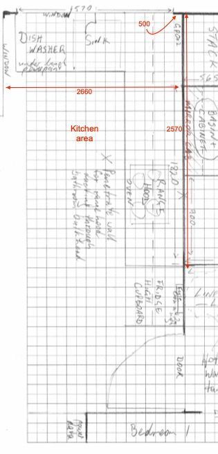

I would be more than happy to draw you a kitchen layout design. If you can provide me with the dimensions of the room, the position of the entry and exits plus the location of the windows. We can then explore the possible kitchen layouts and perhaps help you with your query about having high ceilings.

Re: How to extend Kaboodle wall cupboards to ceiling

Hi @rocker
Thanks for posting those measurements, give me a few days to draw up a sample layout for you and we'll go from there.

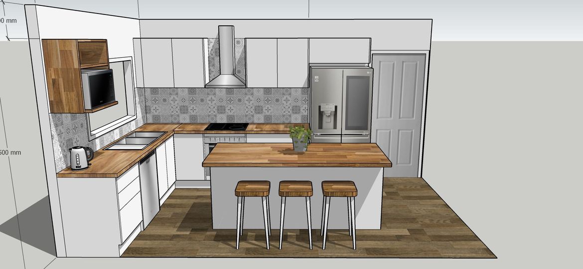

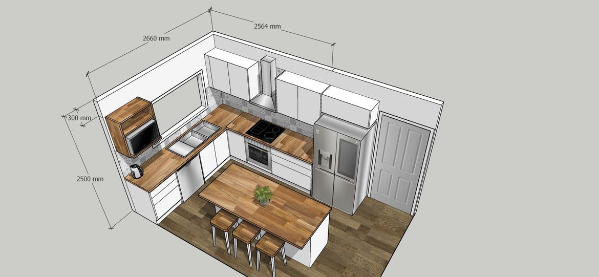

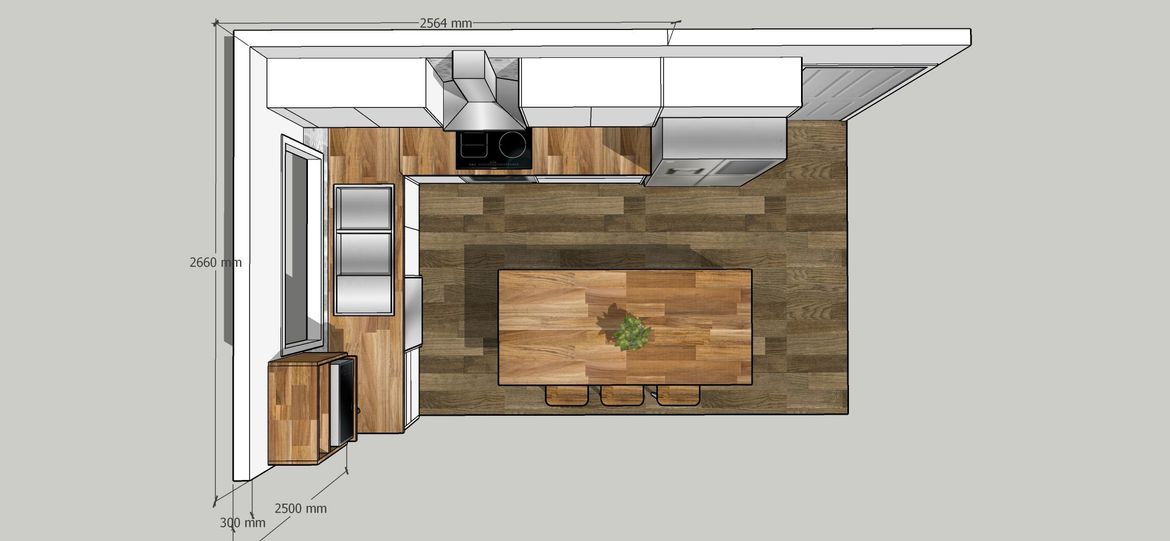

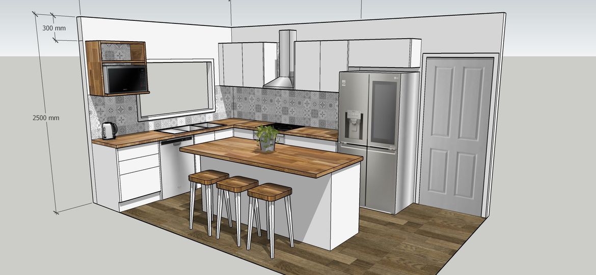

My apologies for the late reply. Here is the initial sketch of your kitchen, you'll notice that the 300mm gap between the wall cabinet and the ceiling is not so bad. However, I forgot to ask is it a gabled ceiling or is the ceiling uniform in height? A popular technique to distract your view from the high ceilings is to install fake rafters and joists across your ceiling. These timber pieces are usually painted in either a natural wood colour or a contrasting colour to the walls.
Please have a good look at the sketch and if you wish to see it in another configuration, please let me know.

Thanks @EricL for going to the effort. Yes the ceiling is uniform 2.5 m.
I can see Kaboodle does not offer the flexibility I need. I REALLY do want to hide that area to the ceiling. The reason is that I will need to run the duct from the range hood to the exterior above the wall cupboards to avoid taking up cupboard space. Definitely do not want fake joists.
I reckon a simple board can be fitted above those wall cupboards. As long as I can get the same finish in the required length. And that means I will need at least one end panel to run at the side of the fridge from floor to ceiling so 2500 long. Does Kaboodle make that?
I will also want a hidden range hood cowling, so another cupboard for that!
All advice considered and appreciated.

Thank you for adding that extra information about your proposed kitchen project. Unfortunately, Kaboodle does not have a continuous panel at 2500mm. I'm afraid you'll have to join several panels to cover the top. The other option is to build a bulkhead frame and cover it with plasterboard or MDF.
The plasterboard can be coloured in the same finish as your wall or if you use MDF you can paint the panel in high gloss to mimic the finish on the Kaboodle doors. I've placed an updated drawing below, if you have any other changes you wish to make, please let me know.
