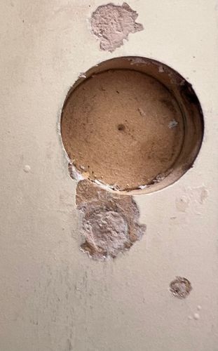

I need to replace the hinges on one of the kitchen cabinets .The old hinges used screws that were pretty big due to which there are these two big holes on the side .The news hinges I bought from Bunnings have very thin screws so I am unable to get the news hinges on.
Can someone suggest the best way to fill these holes that will not only allow me to redrill holes but also will be strong enough to hold the weight of the door ?

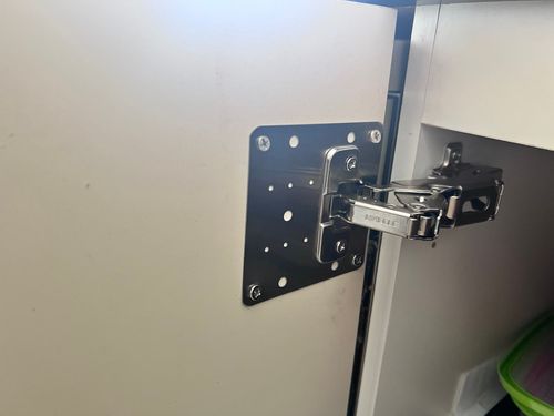

Coming  back to update on this poster …Hey @JacobZ  …builders bog worked really well ..it created a strong bond with the wood ,one that was strong enough to hold up the door ..I did  also use a door repair kit I had already purchased  ,but I think the builder big would have been enough
it did though take me a few goes before I figure out the right mix
