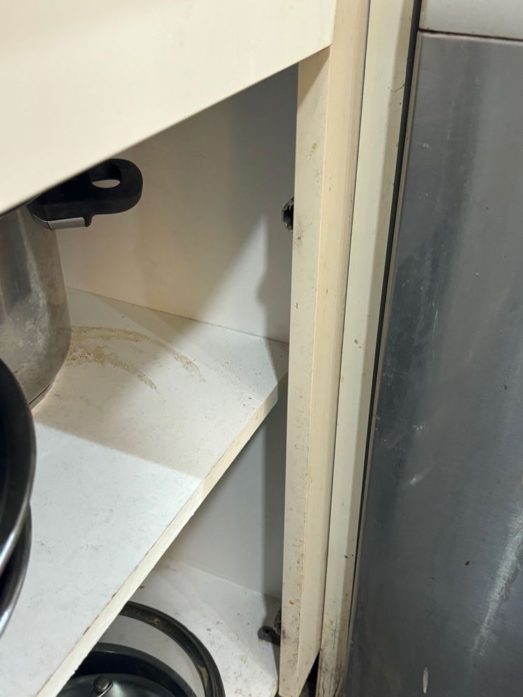

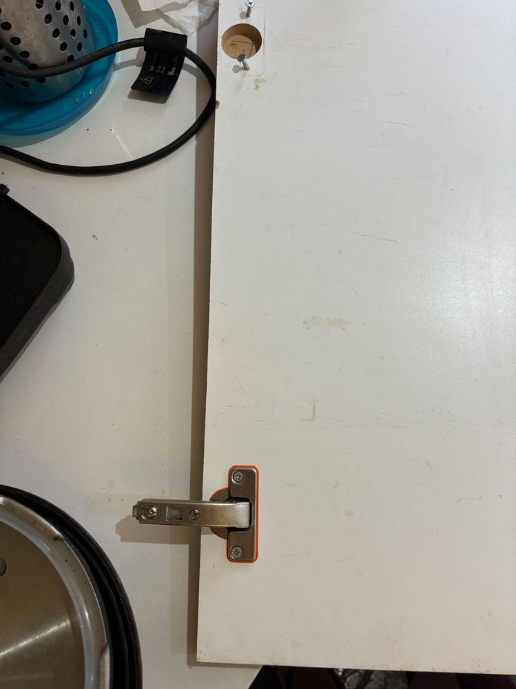

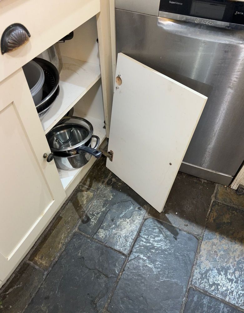

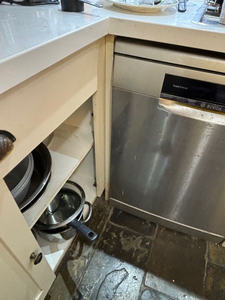

Dear folks
Looking to replace one hinge for our kitchen cupboard door and a friend of mine told me it is called dead corner hing
I failed to find it at Bunnings,,,,Is it a special order or it is an obsolete item ?

@zillah I believe what your after is a "Blind Corner" hinge

Hello @zillah
Thanks for sharing your question about your cupboard hinges. I believe @Nailbag beat me to it, the product you're after is the Kaboodle Blind Corner Cabinet Hinge - 1 Pair. To make sure you get the correct size, I suggest removing one of the working hinges and bringing it with you so that you can compare it to the ones at the store. Should the hinge be slightly shorter you'll need to drill new mounting points for the hinge inside your cabinet. Please note that both hinges will need to be replaced in order for the door to operate properly.
