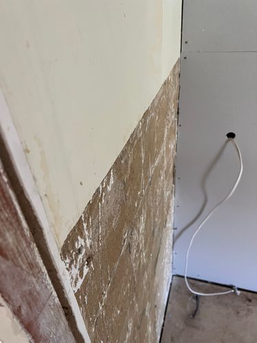

this is the section I’m interested in flushing and having suit the rest of the wall
Hi @smittyboi,
It sounds like the easiest option would be to plaster over the area. If the sheeting at the top is proud of the lower wall section and since the top sheeting would require some preparation work before it's ready to paint, removing them and re-sheeting the entire wall with new plasterboard might be best to achieve your desired level of finish. Remember your PPE, including a face mask, safety glasses and gloves. Also, be aware of asbestos in older homes wall sheeting. If you haven't had it tested or are unsure, it's best to assume it might contain asbestos until otherwise verified.
Here's a helpful guide: Covering a masonry wall Gyprock plasterboard.

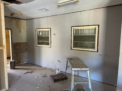

Morning @smittyboi
Nice work so far ![]()
I would follow @MitchellMc's recomendation and remove the top and bottom (The top looks like the paper has been torn) and make it easier on yourself especially since you are redong the plaster on the walls. Cant really tell what the bottom part of the wall is? It kind of looks like bricks but I think its the left over tile impressions. If so, how did you remove them without punch the plaster! ![]()
Thank you for the photos ![]()
As I’ve said multiple times it is not plaster it is double brick and there is a layer of something over the top of it to make it flush. The paper you are seeing is existing wall paper. I’m just wondering what product is used to flush over the top of a double brick wall

I think the confusion lies in the fact that just because a wall is double-brick doesn't mean it can't have plaster over it. As you mentioned above, "half of it is flushed with a material I’m unsure of", so I think we presumed that there's a good chance what looks to be sheeting above and possibly below could be plaster. Thanks for clarifying that the lower section is indeed brick.
My advice still stands as above; it is likely best to remove the mystery material above to achieve a flat surface and then sheet the whole wall with plaster. If you don't want to remove the material above, you'll need to check its thickness and sheet the wall below with something of an equivalent thickness. If you can measure the thickness of the top material and let me know, I can have a look for a suitable material to flush it with.
No there isn’t drywall over the top! I’m just asking if plaster is a suitable putty to go over where the tiles are ripped off or a different substance is recommended
