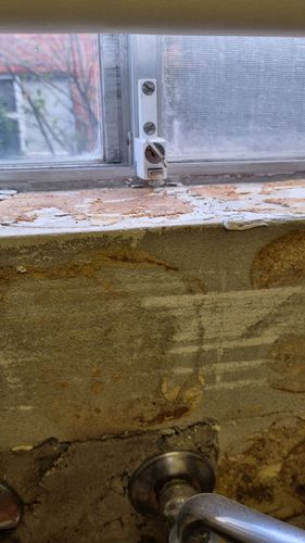

 apologies for the prior photo of the tile not being clear - the tile is on mesh and contains small mosaics, not a solid tile.
Here is a photo of the window sill, we have since removed the old adhesive.
Would a tile edging strip be suitable if we use the mosaics on the sill as well as wall? As opposed to using a subway on the sill that meets the mosaic at the join of the wall and sill

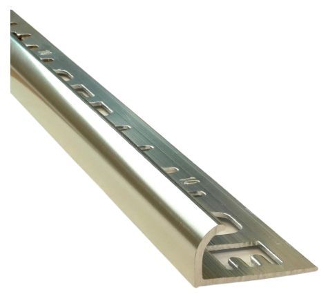

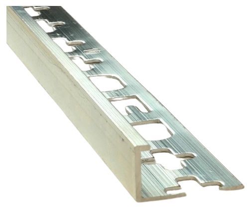

Thank you for sharing those extra photos of your kitchen wall. I propose looking at the QEP 10mm x 3.0m Silver L Shaped Tile Trim Angle or the QEP 10mm x 2.5m Aluminium Round Edge Tile Trim. These are the most typical trims used on ends, corners and window edging. If you wish to see what the profile will look like against your tiles, I propose purchasing both and testing it against your mosaic tile sheet (you can exchange the one you don't like). Once you have the trim on, you'll get a better idea of what they will look like once attached. If you are happy with the look, you can then commit to the profile trim you've chosen.
