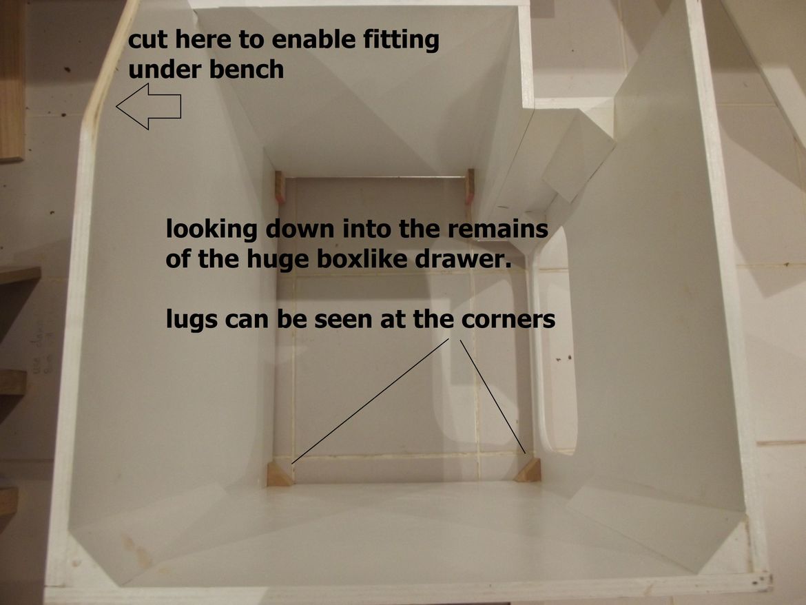

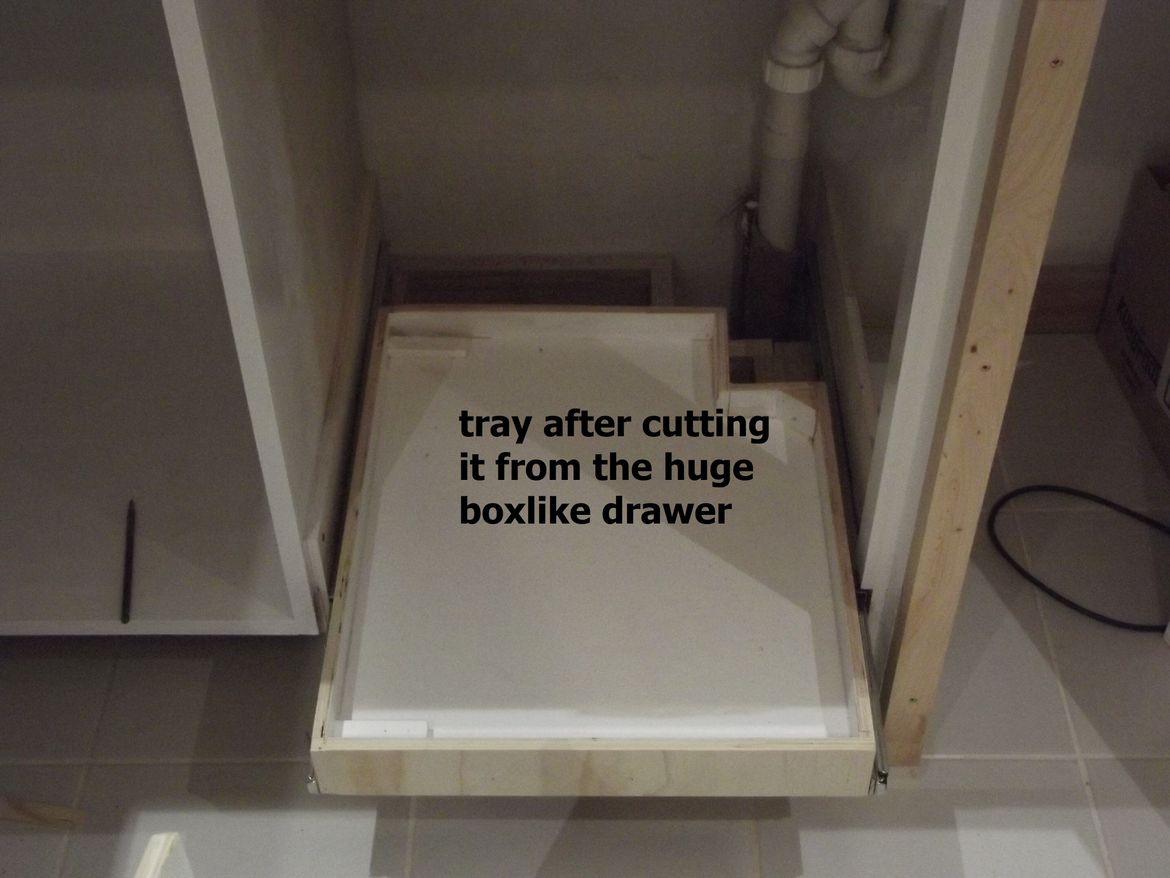

The 800mm deep 500x 500 waste 'drawer' was just too hard to fit onto the push to open runners...my final solution was to cut off the bottom of the drawer !

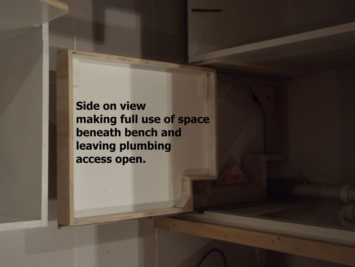

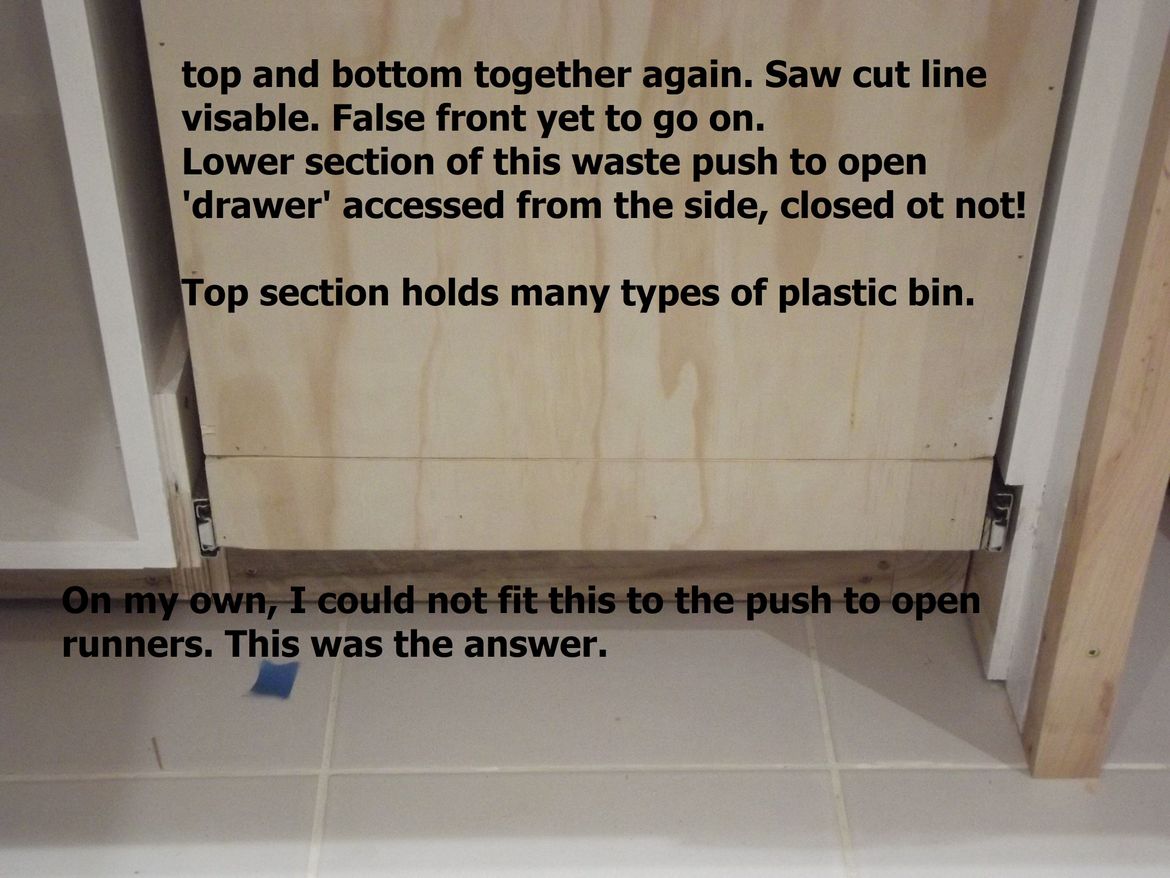

Fit the runners to the 80mm deep bottom part ( now just a tray)...get it right...slide it in, check it worked...tick... and then fit the top back in place using the small wedges of ply glued in place inside the bottom walls of that section of the drawer. Yes the neat sawcut shows but it will be taped over
and a false front goes on anyway. It works a treat. Job done.
