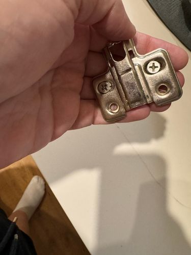

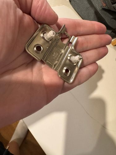

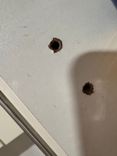

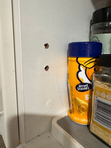

hi! The door has fallen off my Kaboodle kitchen. This is the holes and the bolts I have. I was wondering if you would have any suggestions on how to fix it?
Hi @m_ee_e,
Did the rear holes have screws in them? If not, I'd probably remove the screws from the plastic plugs and push them back into the holes with a little Liquid Nails. Tap them in lightly with a hammer to ensure they are fully inserted and flush with the cabinet surface. Wait 24 hours for the glue to dry then mark out the location for the rear holes and pre-drill the cabinet. You can then install all four screws.
Alternatively, you can follow this helpful guide: How to replace a kitchen cabinet hinge. With this method, you'll fill the holes and re-drill new holes for your plugs.
