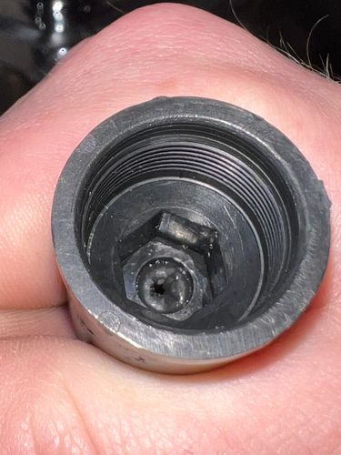

we are stuck with what to do now - we have pulled the end out to check the vege hose, and we can see that the opening is a tiny hole - is this normal? It seems that the tap has pressure in it, as when we take the aerator off the water SHOOTS out like you wouldn’t believe. We believe that due to this, the water is hitting the aerator as such speed that it is counteracting the flow too much.

Could I also trouble you to get a photo of the hole in the veggie hose that you mentioned?

3. no trouble, I will try and get a photo when I am home and will upload it here

it looks to me like it’s a manufacturing fault? Surely the water shouldn’t be expected to flow through a pin hole?
