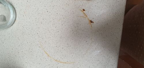

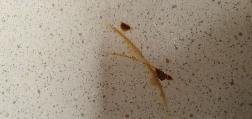

Can I please fix the marks or kitchen top as you can see in the picture as i am living in rental property.

I suggest using dishwashing soap and water in combination with Mr Clean Sponge Scourer. Using the green pad of the scourer gently rub the burn mark while it is wet with soap and water. Once it starts to fade use the yellow foam side to finish the surface. If the some of the burn stains are persistent use the Mr Clean Melamine Eraser Cleaning Pads. Make sure to use water on the melamine eraser and do not use it while it is dry.
Once the surface is clean and dry use the PC-11 56g White Epoxy Paste to fill in the chipped sections. Make sure to mix well and do not overfill the chipped section. Please note that the filler will dry off white. If you wish to touch up the filler you can use British Paints 250ml White Sample Pot - 250ml in the same colour tone of your benchtop.
