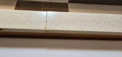

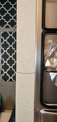

Hey Bunnings community,
I have a crack in my kitchen bench unsure what has happened. Any advice how to fix it.
Re: how to fix crack on the kitchen bench
Hi @ramzyatallah,
It looks like you have a Caesarstone benchtop, which has cracked the whole way through.
Unfortunately, the only great solution would be to widen the gap, apply a specialised adhesive to secure the parts to each other, then apply a filler product over the top to conceal the crack.
Due to the complexity and risks from grinding that would be necessary to carry out this repair, I would suggest you contact Caesarstone to get a quote from a professional repairperson.
If you are just looking to cover the gap, you could try using PC-11 56g White Epoxy Paste, but it is likely that it would stand out and it may crack due to movement quite quickly.
