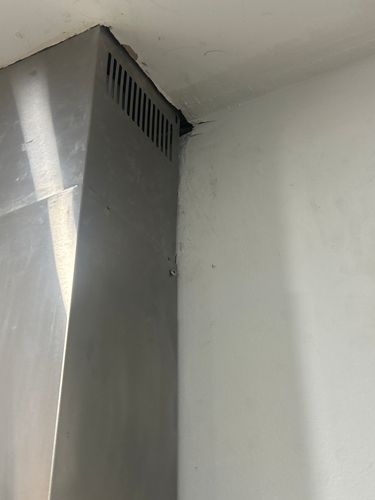

I recently installed a new range hood but some of the plaster has come away from the wall/roof when removing the old one.
What would be the best way to fix this?

I propose using UNi-PRO 500g Multi Purpose Interior Filler - 500g to fix the damage of the chipped ceiling. Your goal is to fill in the chipped section to the same level as the ceiling and not overfill it. Once the filler cures you can then sand the surface level. The remaining steps will be to wipe away all the sanding dust and paint the chipped section of the ceiling.
Here is a handy step-by-step guide: How to patch a plaster wall (some of the techniques used are applicable to your project)

Trim all three sides with quad timber.
https://www.bunnings.com.au/search/products?page=1&q=quad+timber&sort=BoostOrder
If you don't have one get this.
https://www.bunnings.com.au/craftright-mitre-box-and-saw-set_p0490021
Cut, paint and secure with something like liquid nails or similar adhesive.
