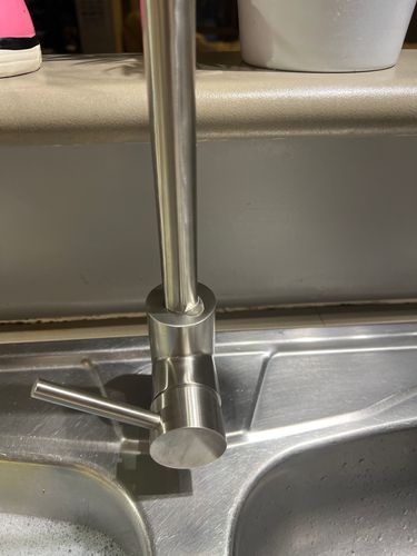

I have just installed this new mixer and the handle is leaking. I have tried tightening it but didn’t work and I still need movement in the handle so couldn’t over tighten. It seems the two O rings aren’t thick enough to seal. Tried plumbers tape and still nothing.
Suggestions welcome.

It appears that the leak is occurring near the spout joint. Behind the spout is a hole that has a grub screw that holds the spout in place. I have a feeling that you are aware of this as you've mentioned that you tried tightening it. Using your Allen key, I suggest removing the grub screw then the spout and replacing the O rings with the Kinetic Assorted Sizes O Ring Kit - 43 Pack and lubricating it with Kinetic 15g Tap Lubricant. This will prevent the O rings from getting torn apart when you reinstall the spout. My best advice is to use a generous amount of lubricant so that the O rings seal properly.

I appreciate your advice and thought as much. Bummer I have to buy supplies to go with a near on $200 mixer.

If you still have your docket, there is the option of exchanging the tap unit for another one. However, I believe replacing the O rings is a faster repair option.
